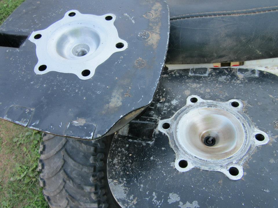

OK, I see some problems.
Squish angle should be 11' not 15'(which is stock, not good)
Volume should be 18-22cc, 16.3 sounds like a stock planed head.
Squish clearance should be 0.035" or larger, so I hope that is a typo.
Here are examples of rechambered heads, note the bowl shapes:
The head on the right is the stock chamber, just shaving it closer for more compression is not a good thing to do. You have to rechamber the bowl.
