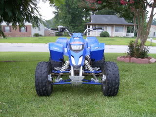

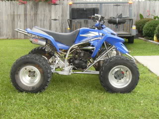

Heres my 05 that I bought new in 06, lots of modds.

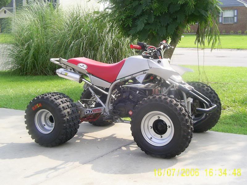

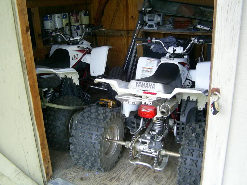

Here's my 04 and my 05 I had at one time,...

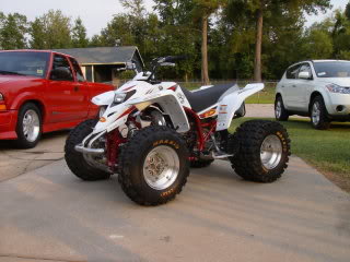

Here's my Vito's 240 Blaster,...

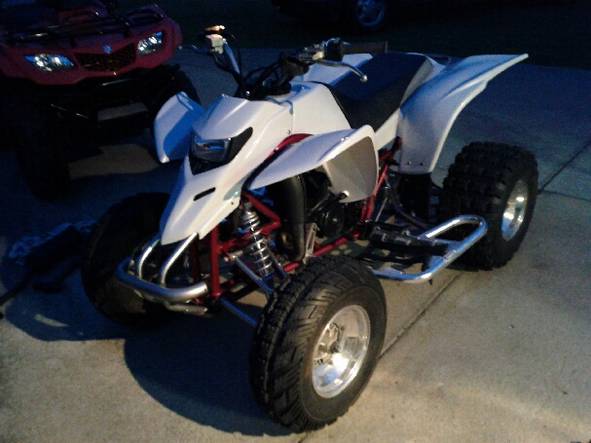

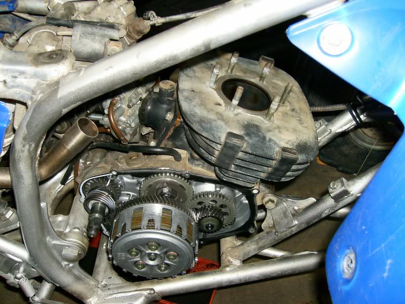

Here's another 05 I got that was a total basket case and built.
Here it is with the lowering kit I fabricated for it.

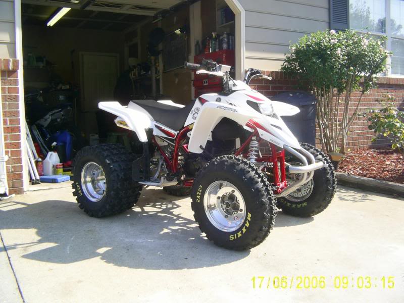

Here's my 02 and by far the fastest one I've built

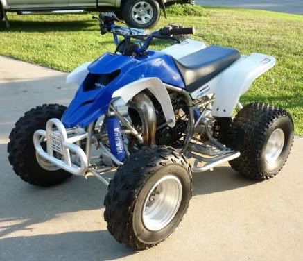

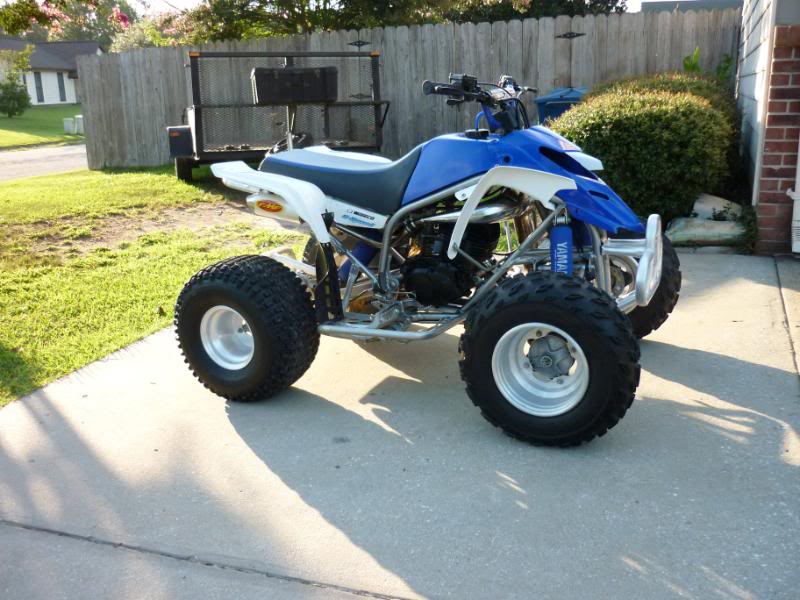

Here's my newest the 04, Maier YFZ 450 style white carbon fiber plastic, STI polished wheels, Ambush tires and a bone stock motor, oh yea

any specs on the "fastest" 02 ?
Thanks fellas, the 02 had a Barnett clutch kit, wiseco 80 over piston, milled head, full FMF jetted with open airbox, I did the modds on the cylinder, same as i'm gonna do to the 04 I now have, opened up fuel transfer ports, clean em up and open/polish them a bit as well as clean/sand smooth and polish exhaust port and raise the exhaust port timing 1mm. I also had V-Force reeds, that thing was blistering fast, that's about all I had done to it, did surprisingly well in the 600 ft dirt drags I used to run at the local atv park.

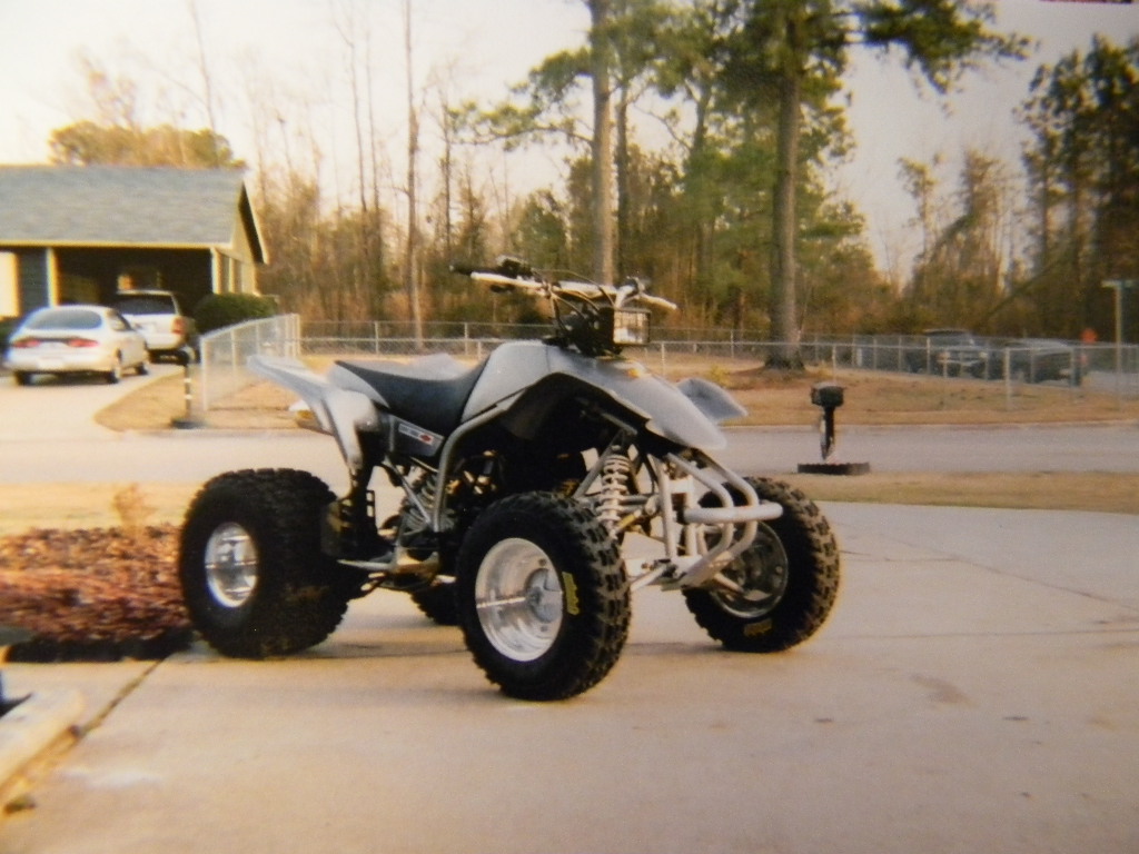

And here's my 01, the first tricked out Blaster I had.
