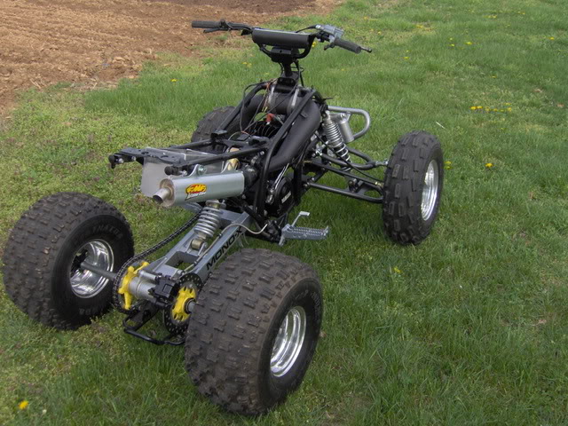

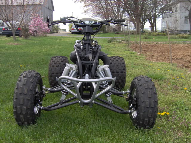

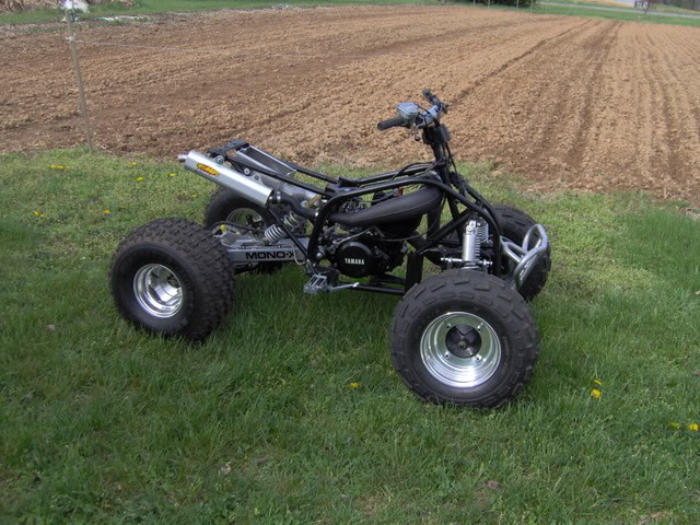

It's a nice day here in Mary land and a good excuse for some picture whoring :). I've been getting her ready for Silver Lake sand dunes in May. Some stuff I did this time around was install new seals/bearings, new pro-lock Shee clutch, paint the motor and pipe, polish the carb, re-polish the kicker and shifter, new chain, changed out the YFZ rear shock for an 06' stocker, drilled out the fuel petcot, fabed a LT500 FMF silencer/sparky and new 14/40 sprockets.
lol thanks guys. I'll be sure to bring back some pic/vids from SL. The trip is about a month away and I'm already stoked I:I
is there any motor work done or stock 400? I bet you wish you could get a yfz rear shock on there ehh?
