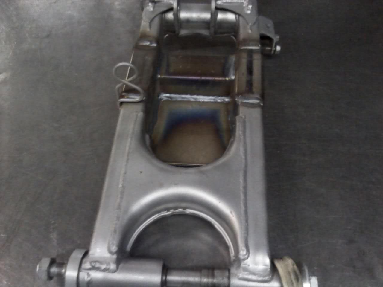

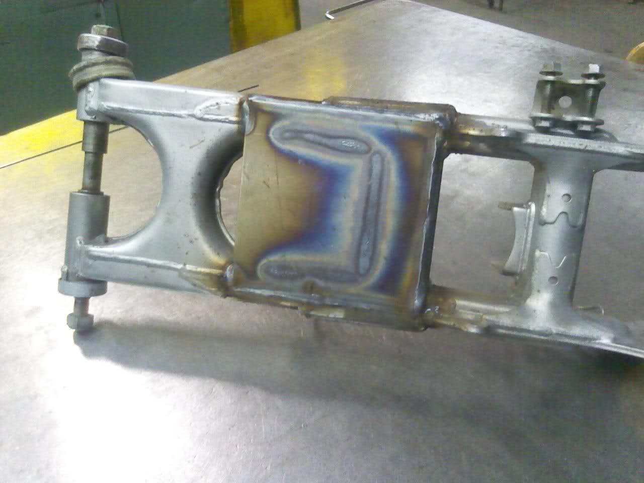

Well, we went back to the shop today and did a little more work on the swinger. We added a plate on the bottom of the swing arm below the welds because of the concern all of you here showed with the welds breaking. It adds a little bit of weight, but not too much. At least I'll know it's more stable like that. We also welded in the cross member for the shock mounts. All that's left now is to fabricate the brackets for the shock and weld them onto the cross member. Here's the current pictures:
Only from the bottom which no one will see anyways.
Better safe then sorry right?
Your man did some nice welds- they look factory!
Yupp, my goal was a kind of factory look. That's why I had it done by a professional welder with professional equipment, in a factory he works in every day. I knew he would do a sweet job with it!

the biggest thing that makes the welds look nice is they are using gas with the mig welder, instead of just flux core wire and no gas...all i can say is welding with gas is just SOOO nice compared to flux core wire lol..
welding is an artform and you dont have to be a pro to be good at it, but that was a smart idea for you to go to a pro if you werent confident in your own welding skills...
