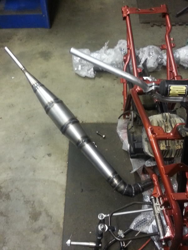

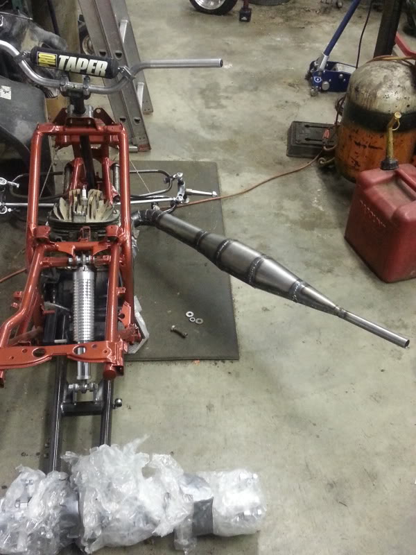

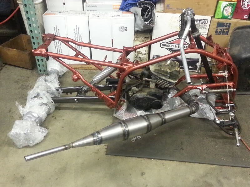

I realize all of that, I understand it would cost that individual time and money to get to the dyno to obtain the information I am interested in. It was just an idea, we will see how it goes. Yes the individual would get to keep the pipe. Id really prefer someone local or close to it. But we will see how and where it goes. Anyways, here is the design I came up with today using our engines parameters. I have a bone stock engine lightly setting in that frame so this is all for mock up purposes. Enjoy!
That looks good, should work alright if you have it all set up good.
Just a general question... Why do all drag pipes go out on these? Why not go out and the turn the small pipe (stinger?) straight back? I think it would look cleaner, and wouldnt stick out the extra foot
Putting more of an angle or bend in your header pipe design changes the pipe design somewhat. It's not impossible, you would just have to account for it and it takes a much longer period of time for the original design. One of these days I am going to get back onto a project I have going on for banshee's. Un silenced full fledged drag pipes, that run in frame and exit side by side in the center - looking kinda like a double barreled shotgun.
