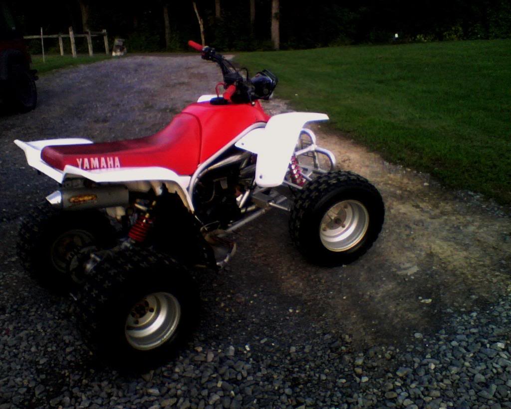

What I have is a 2001 model. After ridding it pretty hard this weekend noticed when turned it off it would back fire out the silencer? Not loud more like flaming sound. New to the blasters don't know if thats the way thay are or needs work? Engine is noisey at idle. Compreshion is good 123 psi. Runs strong no hesitation.
well took the plug out this after noon did appear to be running slightly lean. Never seemed to over heat or lose power. no air leaks I could find. This was my first trip on it
adjusted on the carb. road it tonight It seemed to give it more torque pulls the front wheels nicely now! I:I
I probably need to re-jet the carb. Its stock jetting with fmf pipe and reeds. Just slightly over a turn out on the pilot jet? runs the best.
