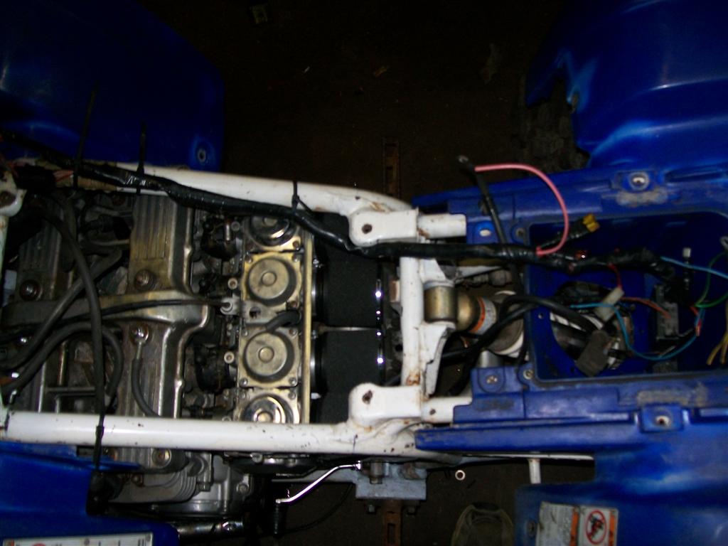

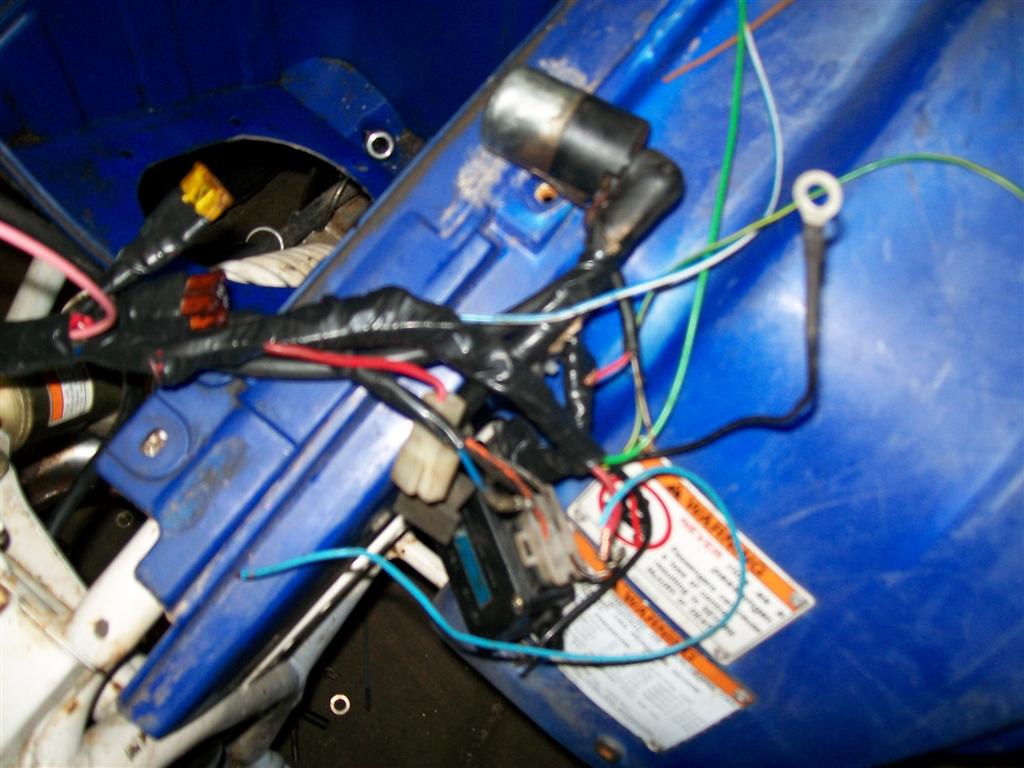

I was able to finish making the main wire harness tonight. I had to make the whole harness... All i really reused off the bike were the plugs.
Holy crap! It looks like the electrical tape monster got ahold to it. I don't blame you, every time I go to monkeying with wires I end up wrapping the harness with about twice as much tape as it would have taken the factory to do it.
Is the wiring now good to go? You running a battery down inside the original airbox?

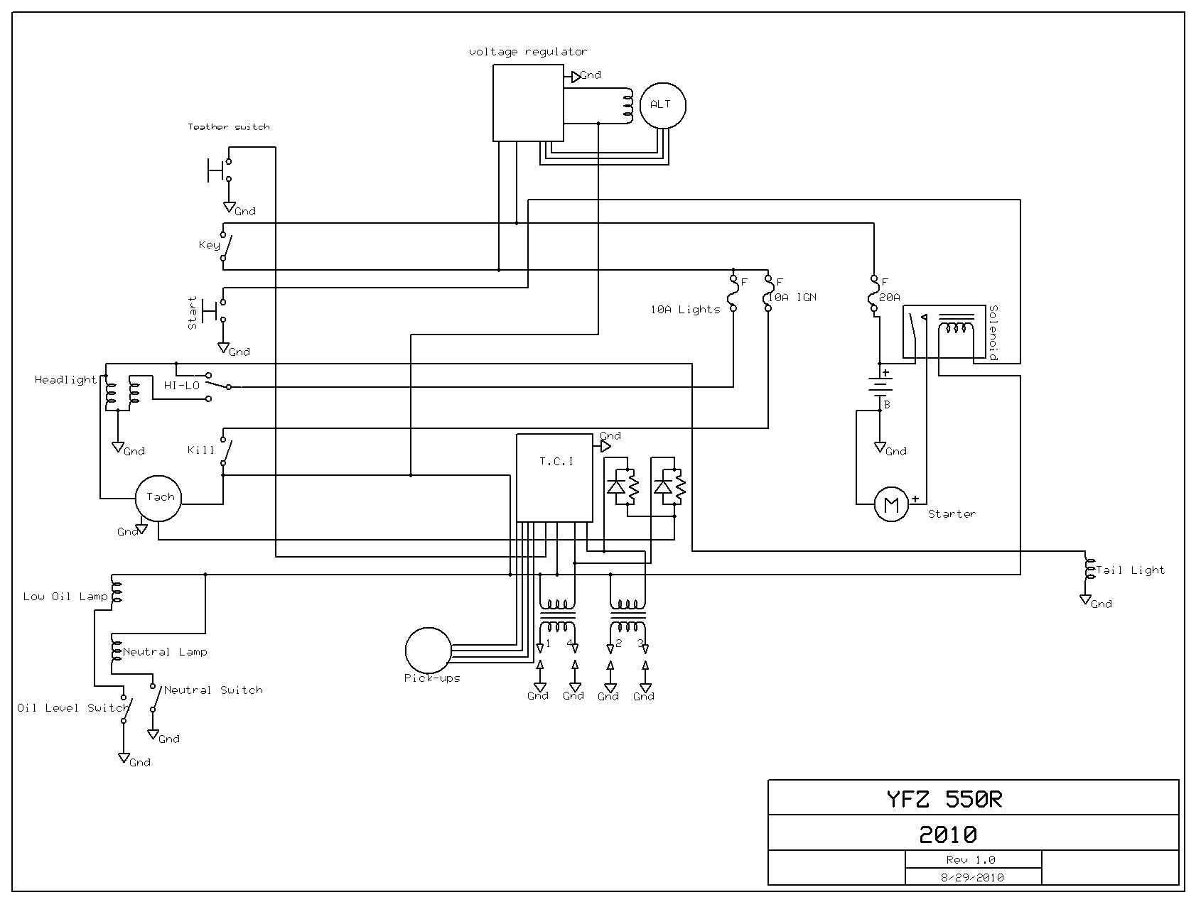

After all that tape.. I forgot a few wires. I need to draw it out first and start over.. but that can wait until after a few test runs. I'll post a copy of my wiring diagram when I get it done.
