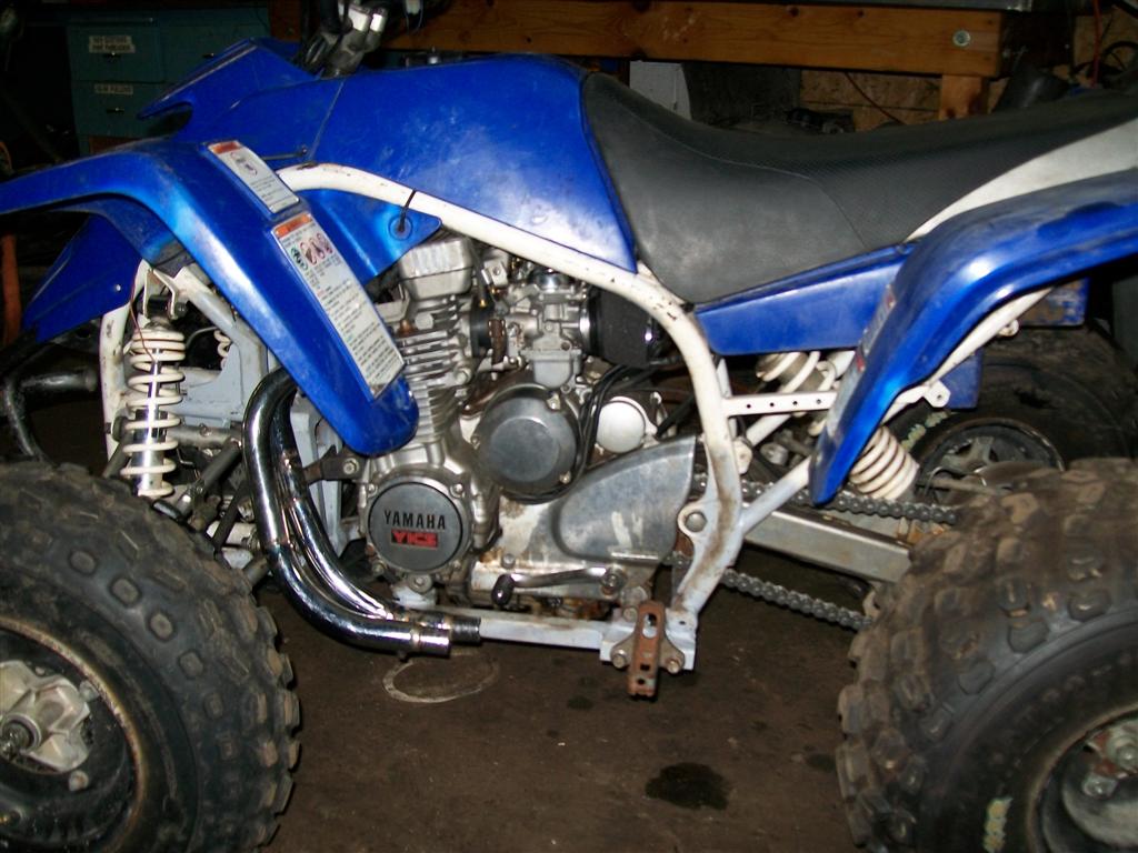

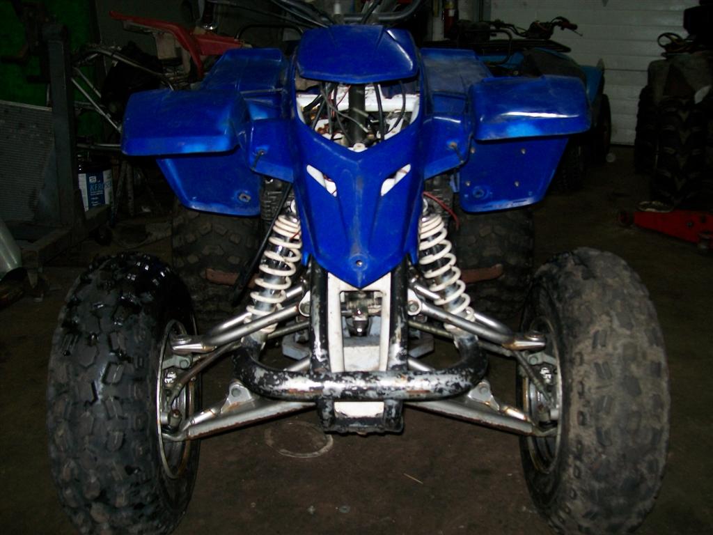

About only having to make 3 cuts to get the pipes out. I'm just curious about how much shoe horning is actually required to get this motor into the frame and all of the stuff buttoned up. Could be a killer swap if it's not too invasive.
Plus it's really fun to call people out with pics or you're lying...
Good call. I'll take pics tonight. It has been too muggy to work outside the last week or so..

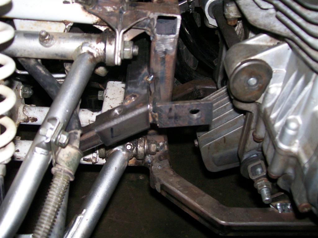

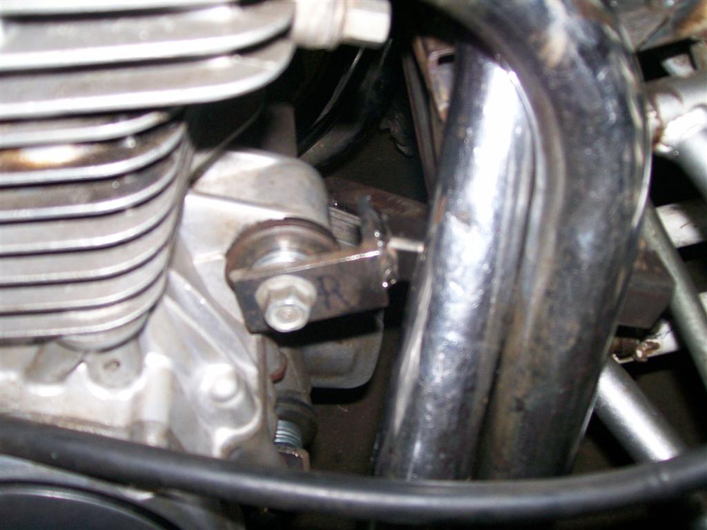

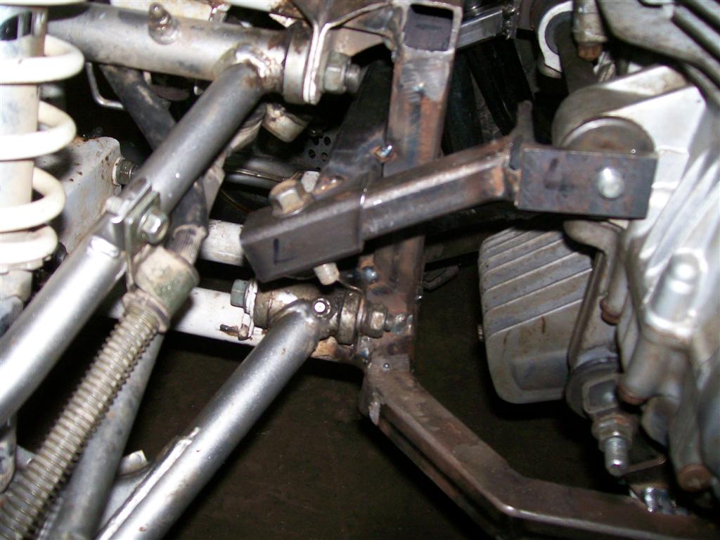

Ok here are the pics of the front motor mounts. They are just tacked for now. This is my first time building a frame so it might not be pretty.
The first pic is of the motor mount installed. The second pic shows how it unbolts and moves out of the way so the motor can be removed from the frame. The last pic is of the mount on the other side of the motor. I plan to round off the edge of the mounts so they look a little better.

The motor mounts don't have to be pretty, just functional...

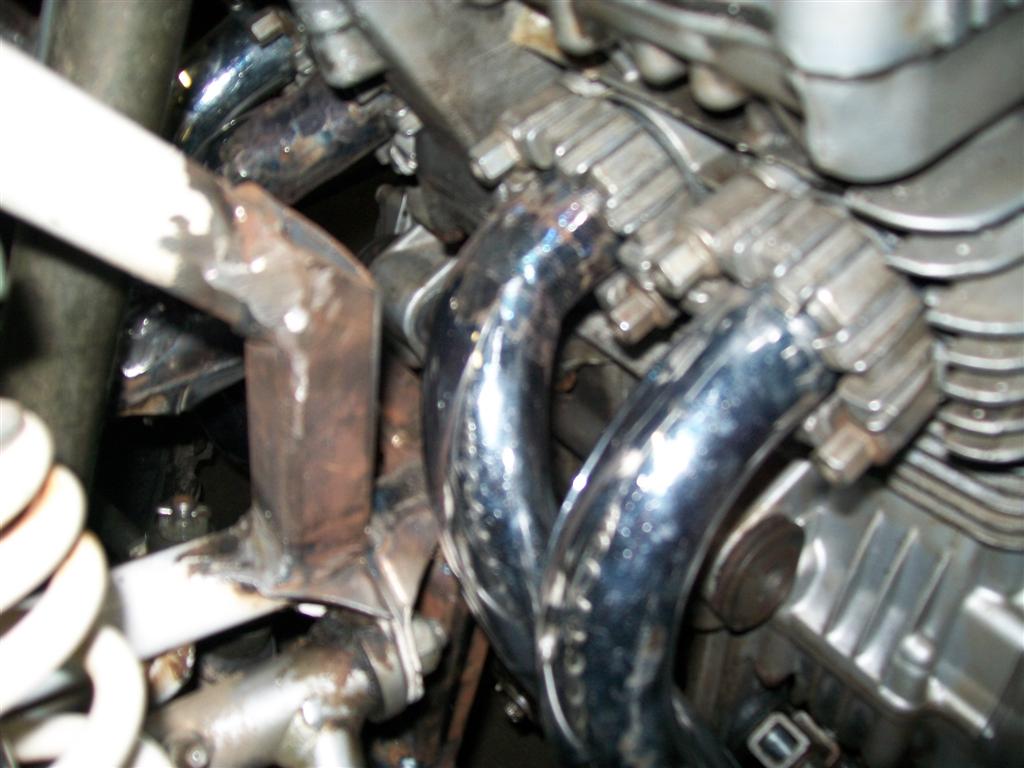

I got the frame all welded up. I also made some footpeg mounts and welded them to the frame. The pegs bolt onto them.

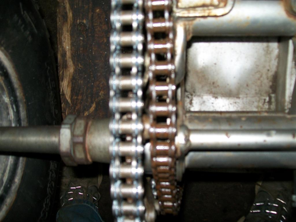

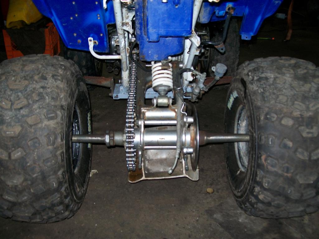

Below are some pictures of the new chain that cost as much as the motor:
Next to the stock 530 motorcycle chain:

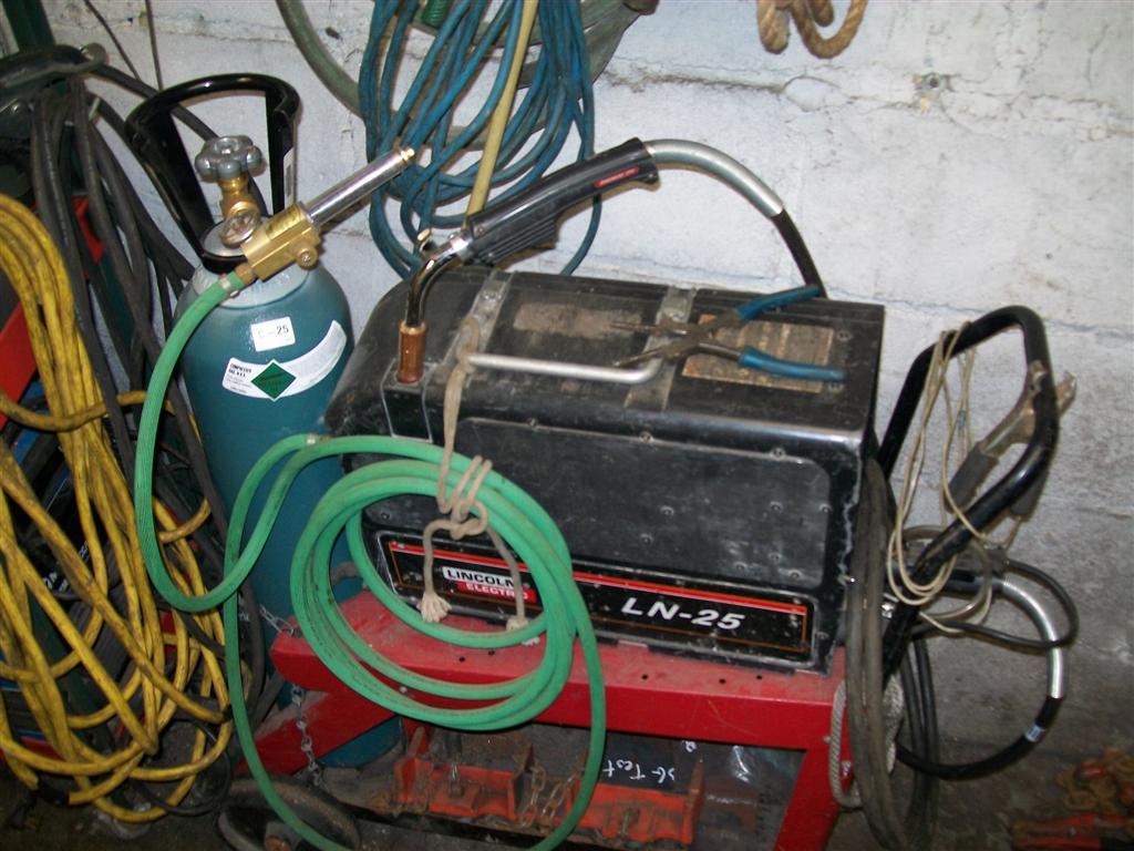

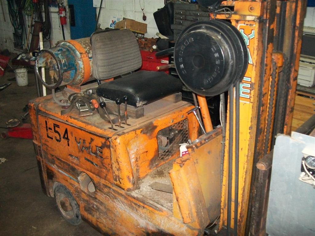

Since this is such a small update, I also wanted to take the time to thank the tools in the shop:
The forklift.. for the 15+ motors it helped removed/install from cars
The Lincoln wire feeder..
And for the Miller power supply..

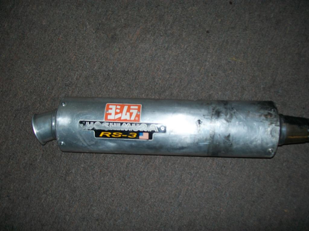

Okay I took a trip to milwaukee cycle salvage today. I didn't plan to buy anything because I was on my motorcycle. ... but then I saw this Yoshi on a shelf of about 100 other pipes... It has some small dings and such but the price was right. I think it will look good on the blaster

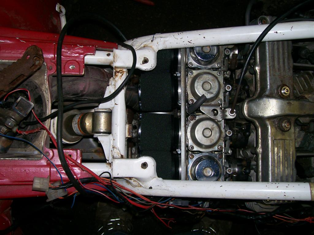

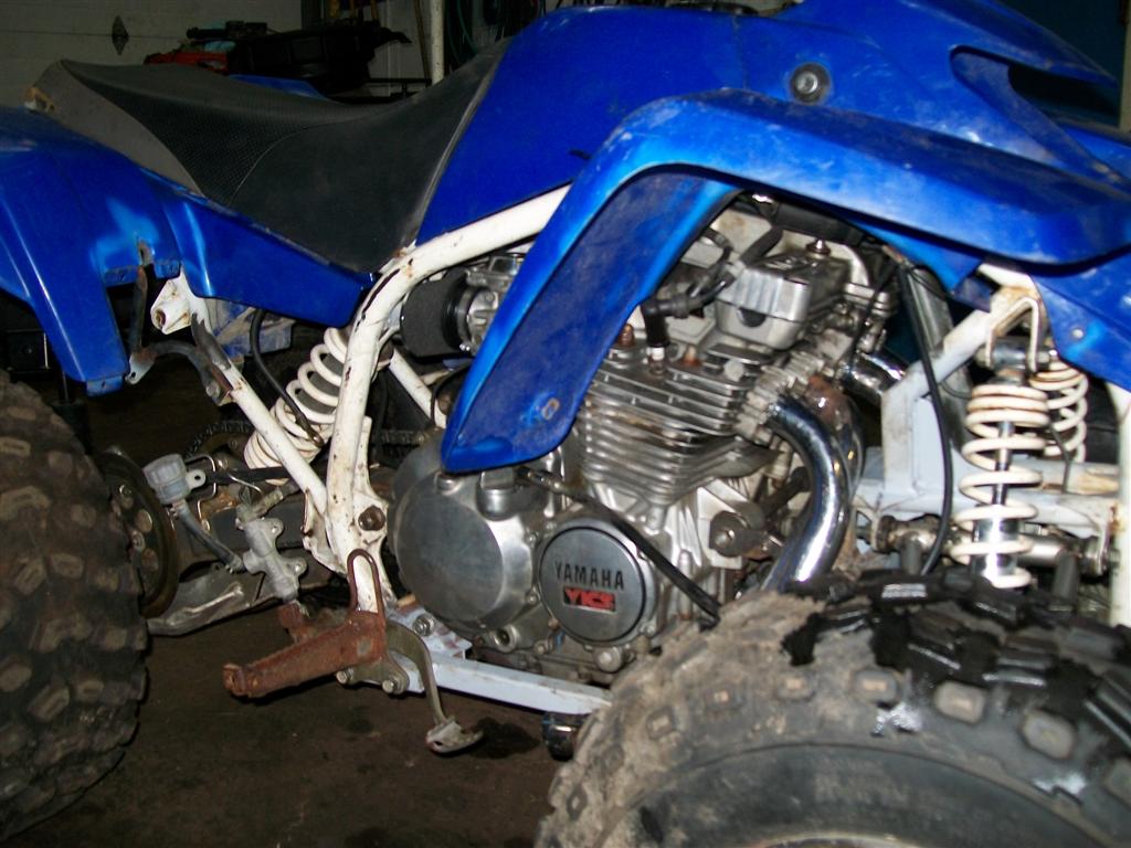

I got everything back together. The plastics are re-installed so I can fix some of the mounts I had to remove to fit the motor. I fixed the headers so they all point stright back. I will finish the rest of the pipes soon. I also started the final wiring. I am using an AGM battery so I can lay it on its side at an angle in the air box. The ignition box will be in with the battery. I'm not sure if I will mount the voltage regulator in the small rear box or outside some place. I'll have to see how hot it runs. I also found a way to use the thumb throttle.

I just thought of something that kinda hit me while looking at the pics of the gas tank and plastics. Is the gas petcock going to flow enough gas to feed that beast? It might run be ok for short bursts of throttle but if you are screaming on it, is it going to have enough flow? and another thing, are you going to extend the swinger?
