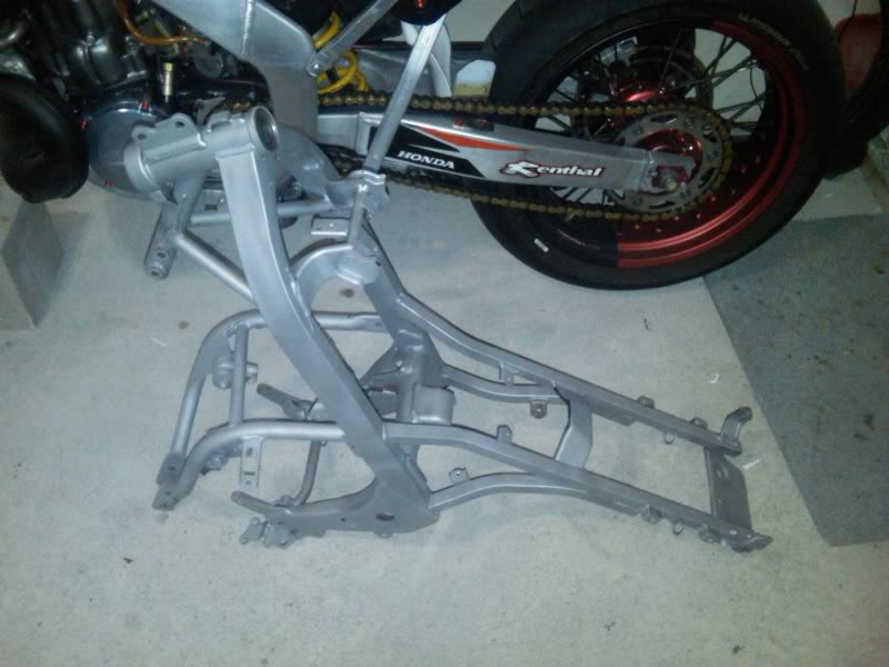

I just got my frame mods finished to accept the blaster engine. Split the cases on the blaster engine I have and found one pair of the trans gears was chewed up. Good thing I have two engines to choose from.
I bought two blasters a while back to use as donors. I'll be getting the crank rebuilt, probably try the Oconnor porting explained in the videos I found. I'll be posting pics as I go.

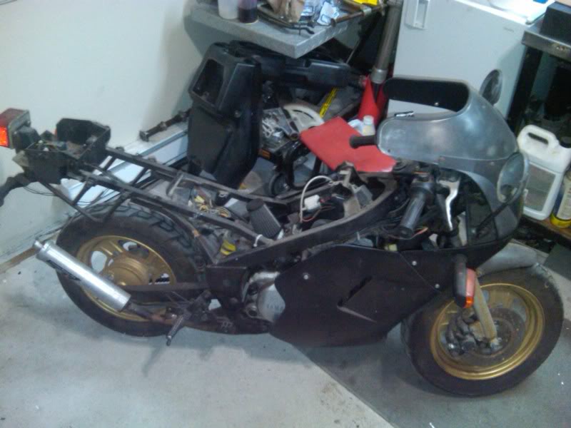

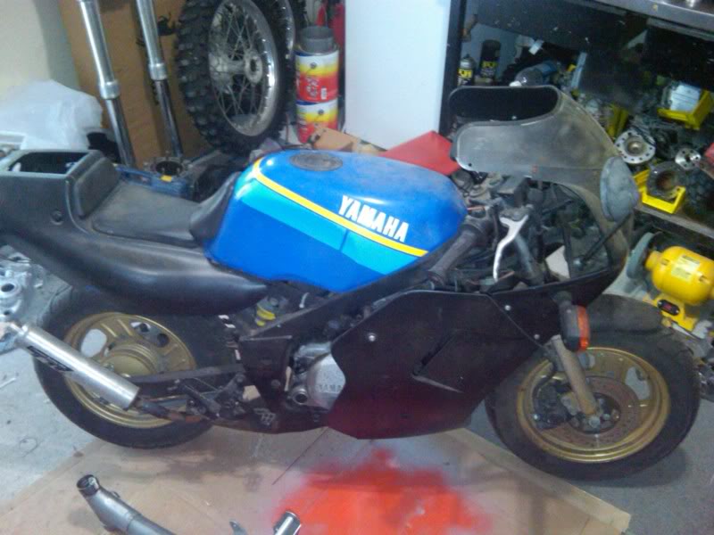

Here it is as I got it:
Thanks! I wanted a YSR since I was a kid. Now they're all beat up junkers unless you go through them this much. I'll take a few more pics later tonight if where i'm at now.

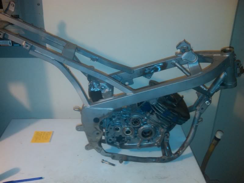

Got my bare cases cleaned up and set in the frame. Everything looks sweet and there's lots of space with this engine. It's actually not a lot bogger than the stock 50cc externally.
Looks to be on it's way to a wicked little machine. Can't wait to see the outcome dude.

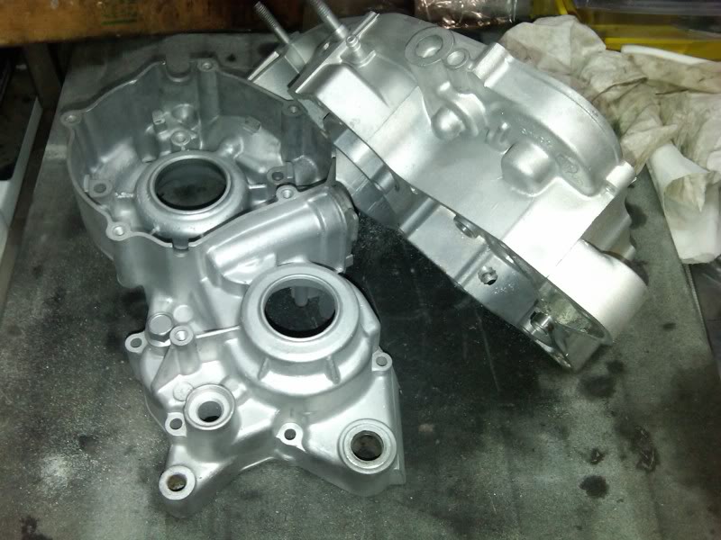

Got my cases stripped down and glass beaded em at work last night. Ready for new bearings and the crank when I get it back.
