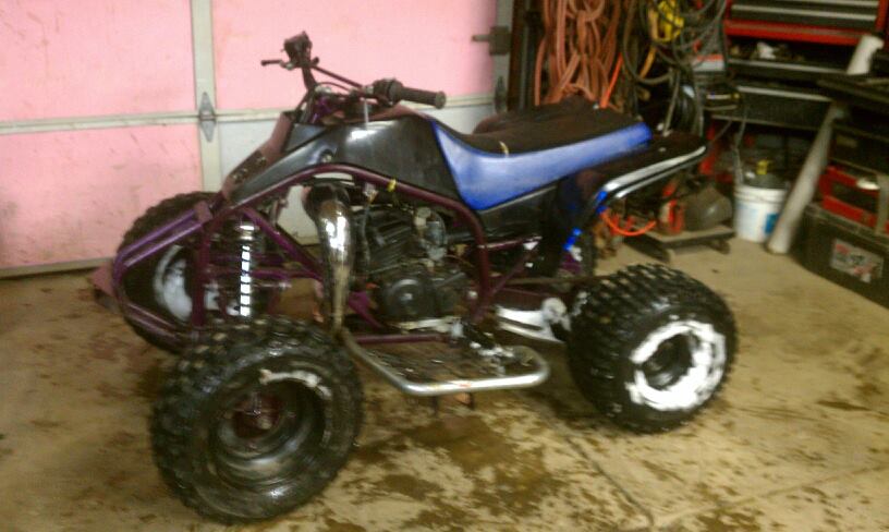

What color is your cylinder and head? If it is factory black, it has probably just been bored over slightly. If it is bare (as cast) aluminum, you may indeed have a BBK. Got any pics of your Blaster? I can probably tell from a pic what you're dealing with.
The thing is this guy painted almost everything on the bike with a black or purple spray can including motor, which i know is gonna effect performance.
. Only one I have currently. Can post better ones tomorrow. I will be surprised if its a stock motor because stock gears and 22 inch tires I was goin 50 in the top of 4th gear.
It won't effect performance. I will probably just burn off the motor. I doubt he used high heat paint. I have a stock cylinder with a 240 sleeve in it. I hate to bust your bubble but if he didn't upgrade the carb, air filter, and reeds I doubt he shelled out the cash for a 240 kit. Most people would at least take the air box lid off for a 240. No way to be sure until you measure the cylinder. I was told my blaster was a 240 when I bought it. It was just the .40 over trick. A lot of people actually think this makes the displacement 240 cc. I hope you do have a 240 kit. You need to pull the cylinder and check on that top end though. 230 with that pie = DISASTER!
