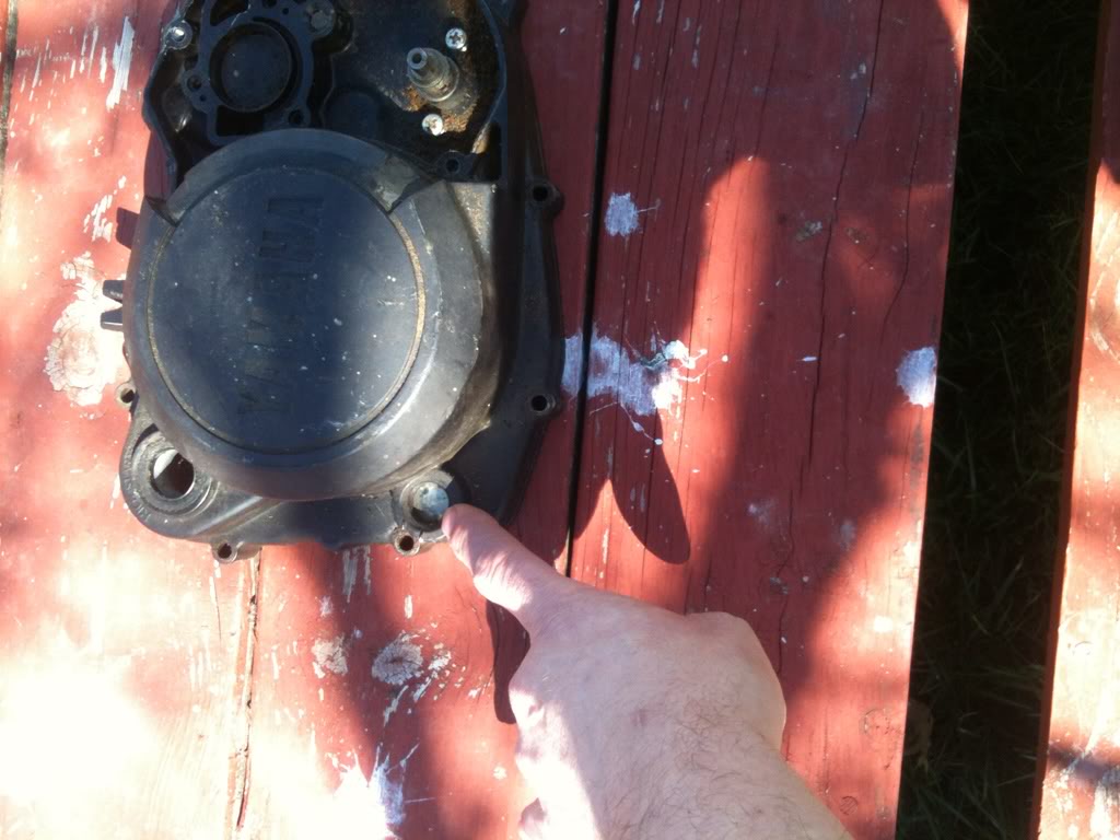

i have a 1991 blaster first quad as u guys may know i post on here alot still learning i have a manuel but it really doesent show any picture of where or what it looks like . i havent been riding because its overfillled i think or its dirty thats y i cant see how much is in it . last time i rode it for like 10 min and noticed oil coming from the breather tube could this be due to overfilling .
ok the window is on the right of the motor below the kicker . you will need to bend your back to see it. chances are your motor is dirty and its disguised!

ok sounds good well i just bought the thing any only rode it a few times its a little beat p but seems to run pretty well i just drained the oil today and found out the guy over filled it by quite a bit like a quart or more i know thats bad for seals and all but could that be the reason for oil coming out the breather hose? Also where can i get the seals i need?
well if your inner clutch side seal is worn, your crankcase will loose pressure via the seal and your compression is ending up in your gearbox pressurizing the tranny casings therefore pushing out the gearbox oil.
Overfill might have been the problem. However for peace of mind do a leak-down test. Then replace seals if necessary. Hopefully you will do the test so you don't waste trans oil.
