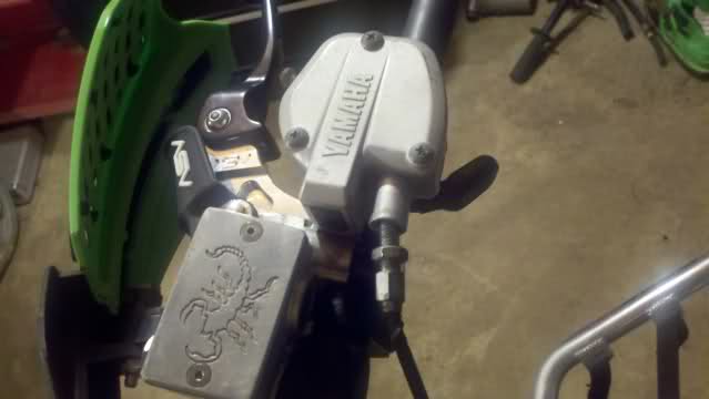

wondering if anybody knows if they make some sort of an adapter that screws into the throttle housing that will take a yz 250 throttle cable. the end of the yz throttle cable is smaller than blaster and will not screw in the housing so i need a adapter. anybody know where i can get one???? was also wondering if there is any place that builds custom cables? need some that are shorter than what i have.

the carb is a 38mm keihin...in the pic you can see what problem im running into. im gonna check out motion pro and see if they can build me cables with the ends i need
if that cable is m8 x 1.25 i think the standard timcert to fix that size will work. I just looked at my throttle assembley and my timecert kit
