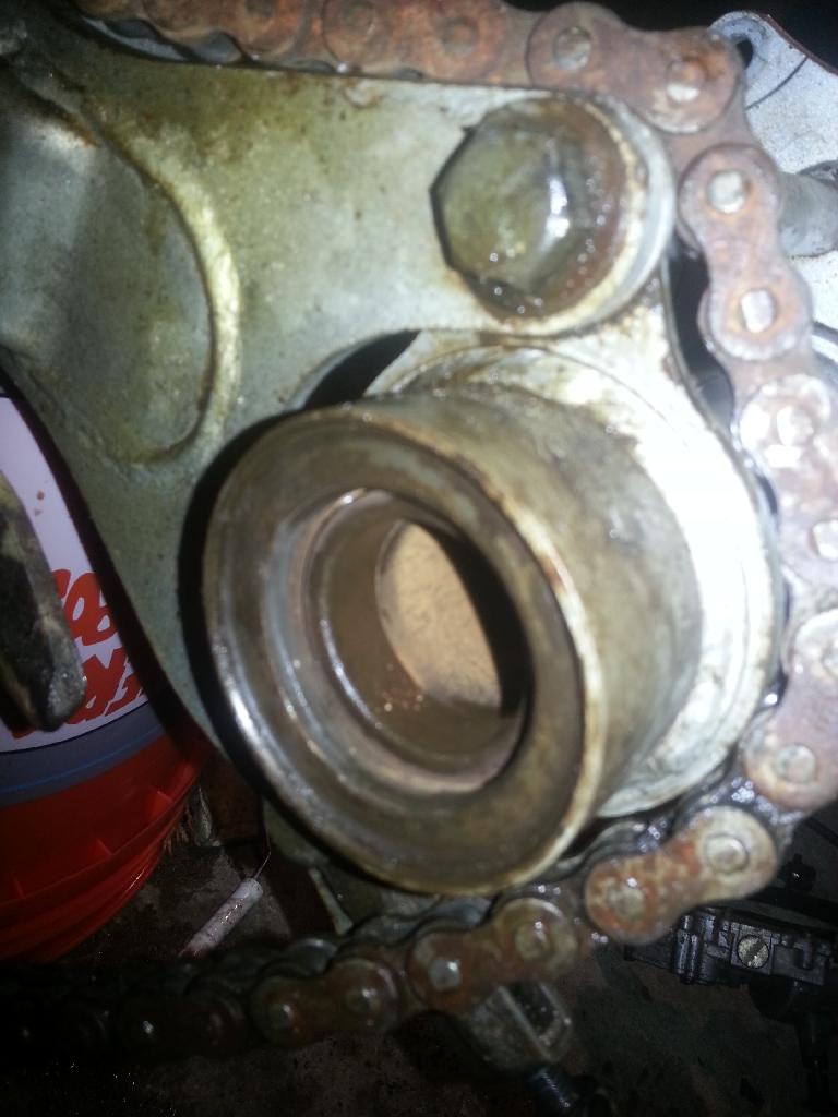

So one of my many tasks is to replace the axle bearings.
God damn what a challenge this is from popping some blood vessels on the castle nuts, the lock and torque nut to this...
I dont know what to do now
Is there a metal lip on this side?
I cant get the bearings/seals out on either side with a hammer

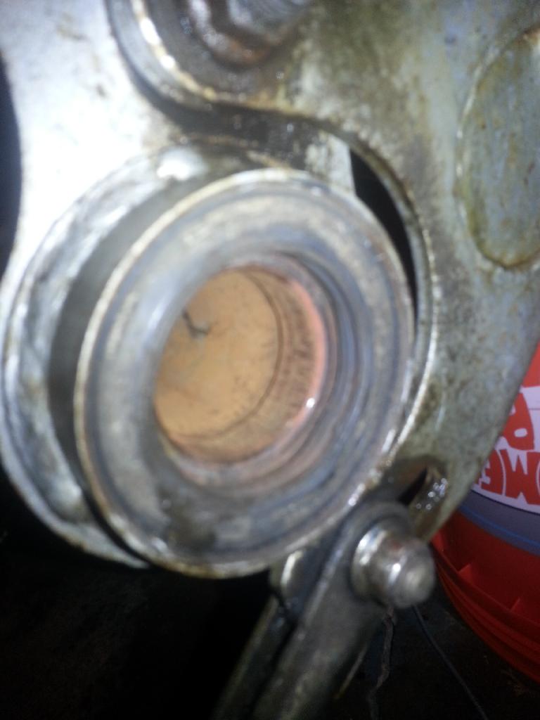

heres the other side
Neither will pry out, it makes no sense...but by looking at this good thing im replacing these.
How the hell do i get all this stuff out?!?!

A blind bearing puller would work nice to get them out. Use a little heat, always makes then pull out a bit easier.
I got a D.I.D. Chain, with a JT sprocket set from motosports for a awesome price. 520 gold non o-ring. Think it was like 109.00.
Fast hand said it best. a bearing puller will do you well. Check at an autoparts store to see if you can rent one.
Those oil seals should pop out. I've had luck getting the seals off with a flat blade screw driver.
The bearings pop for me with a long piece of pipe I have that I tap the opposite side bearing out moving all around little bit of race I can hit.
Get those seals off and soak those bearings with some blaster to help loosen them up. A heat gun on the bearing carrier will expand it slightly also, might help assist you in poping them out.
Good Luck!

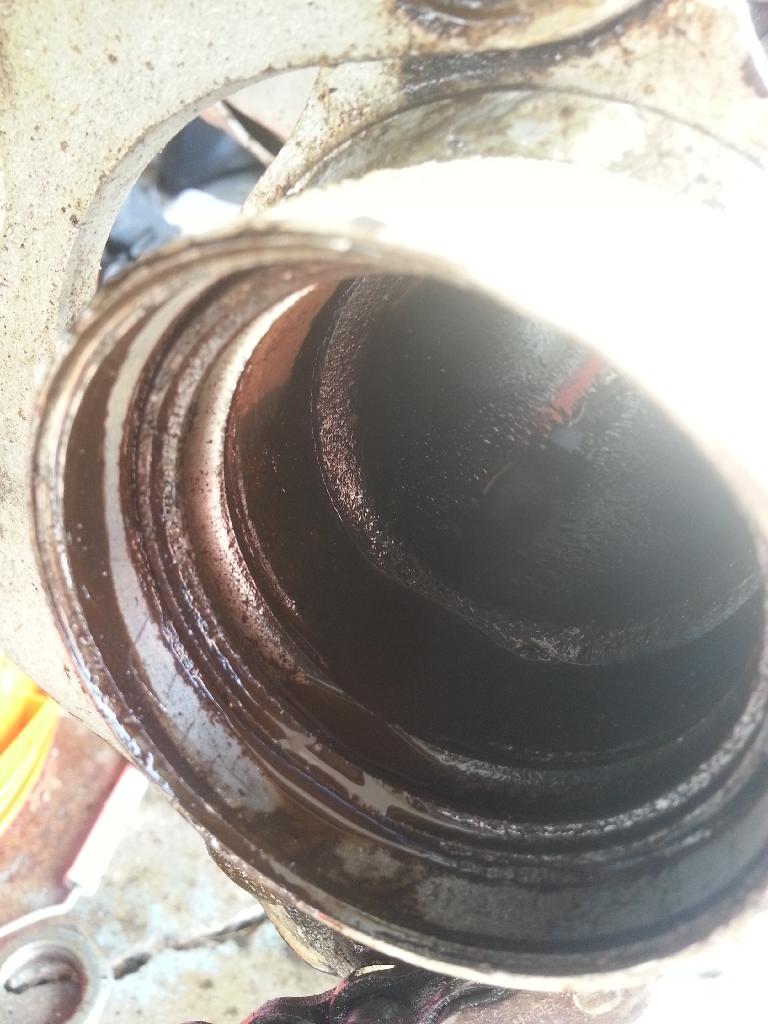

so pretty much do anything i can do get the whole interior of that carrier out? i was prying at the chain side and the outer lip which i though was rubber was bending like metal! i got all confused from that
I marked the parts for you. The oil seal should pop off if you use a flat blade screwdriver and pry out. do both sides.
After that you should see the bearing. Thats when you should soak them, get a bearing puller.
Reactions: bummer981
I got my puller from harbor freight. They also sell a grease seal puller/remover tool. It was like 5-6 dollars and works awesome. It has a orange handle.
