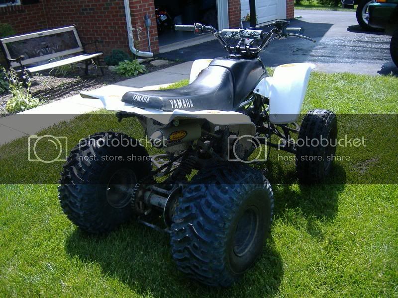

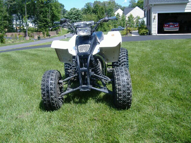

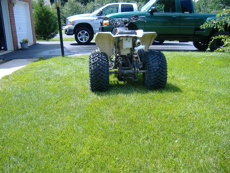

I've had the blaster for almost a week and already put a lot of time and money into it. I sanded the plastics and primed and gave themn a fresh coat of white, Got new rear tires (22x11x8) FMF Fatty pipe w/ FMF Powercore 2 silencer ( I know I know not the best set up) Took it to my buddys shop and he bored and hone'd the cylender .020 over, new pistons,rings,cometic gaskets, 280 main jet (vito's jet kit.) Its pretty quick but im sure with smaller rear's it would be much better. Still waiting on my AC racing front bumper to get here.... Any ways here's a few pics and the first start up after i put the exhaust on today..
They're the same size the left one may have more air making it taller, I'll go look into that, Thanks for pointing that out
Looks really good and sounds good too. Wow those back tires look huge, guess I am used to my 18's. I bet your 1st gear is actually usable with those tall rear tires, nice progress.
