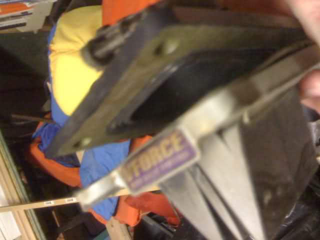

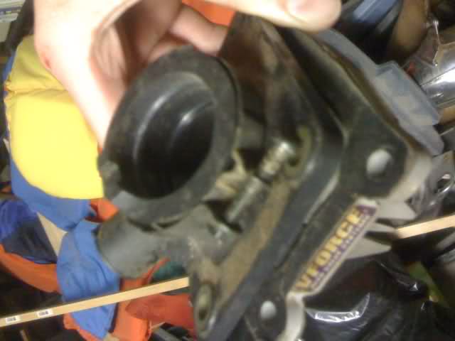

for the piep just unbolt ur old one.do u have the flange for the fmf pipe?and for the reeds you gotta take ur carb off unbolt the 4 bolts on the rubber intake boot on the engine and then the reed cage is right there unscrew the old reeds and put the new ones in.make sure u use new gaskets and bolt it back together.i would start with like a 290-300 main and then do some plug chops to tell if ur rich or lean then adjust ur main jet from there

It bolts onto the exhaust side of the engine and the exhaust pipe slides onto the flange. Also, you probably won't need a new gasket for the reeds unless your old gasket rips when taking it off.

yeah, the reeds shouldn't really affect the jetting too much. you should still definitely check the jetting after you put it all back together
