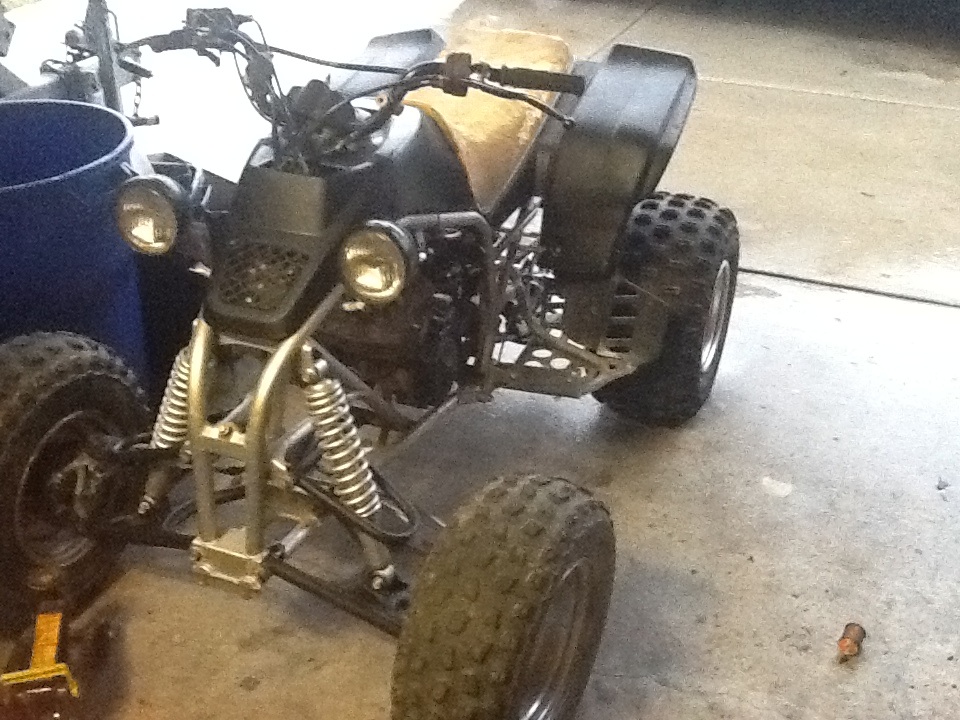

Pic;
Yes and no, I really like the look of those lights like that! I think banshees are kinda ugly in the front end lol
