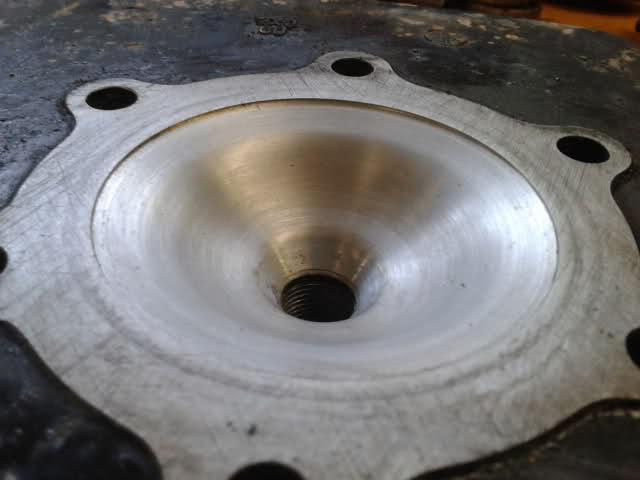

In the video you said that you set the spindle slightly off square with the bed. Could you explain this a little more? I would have thought that the bed being square with the head would be a must. I looks like this would leave a slight concave on the head instead of it being flat. Thanks for the video, having the machine unsquare is something I would have ever thought of.
Its offset is .0005 from one end of the circle to the other. That’s about 1/6 of the thickness of a hair. The offset prevents the cutter from taking the same cut on both sides and back cutting. It’s a very common practice.
I asked in the other thread how flat a head needed to be but was nevered answered. So having the hard with a half of thousandths concave will be fine? I've seen debates on how rough the sealing surface of heads should be, some like a little texture to hold the gasket and some say the roughness promotes leaks. Like I said, my machining isn't from an engine shop. I guess a step of. 0005" would be harder to seal that a concave going from the center out. Once again, thanks for taking the time to put up videos and posting. Its good to having an expert's advice.
The offset is cosmetic only, and like Ken says, commonly done.
The flycutter looks to be over 8" diameter, 0.0005" offset from side to side, the head is only 3-4" wide.
Total concave from center to edge of an 8" cut will be 0.00025"
Total concave from center to edge of a 4" wide head will be less than 0.000125".
That gentlemen, is negligible! :)
The Blaster manual (pg 2-4) says 0.0012" for a Blaster head.
Composite gaskets can take up much, much more.

Thanks, Best. That's what I didn't know. I never thought of looking in the book, lol. So even cutting one with a small cutter, like civic was doing, could easily cut the head to well within tolerance. I only have a 1.5" cutter and if i did one I'd have to make multiple passes but I know I can cut with it with less than .001 steps.
Yes, and the back scratches will not hurt a thing, Ken wants a professional appearance to help sell the product.
Surface finish is not too critical in my opinion. Gasket condition more important.
I've hand filed and sealed 2 stroke heads with just sealer, no gasket, on occasion.

Hand filed headgasket surface:
I would like to point out that as long as you can hold it to within ±.002" you can lap that much back out.
The real advantage to a large diameter flycutter like the one in the video and "cocking" the head on the mill is that it doesn't backcut so the finished cut is ready to use. This is especially important on a larger scale than we're talking. A blaster and banshee head can both be finish lapped to flatness. It applies more to say a Jeep 4.0 I6 engine where one would search for quite some time to find a machinist stone and piece of sand paper large enough to lap that..... One would HAVE to set up the machinery to take it in one continuous swipe with no backcutting.
