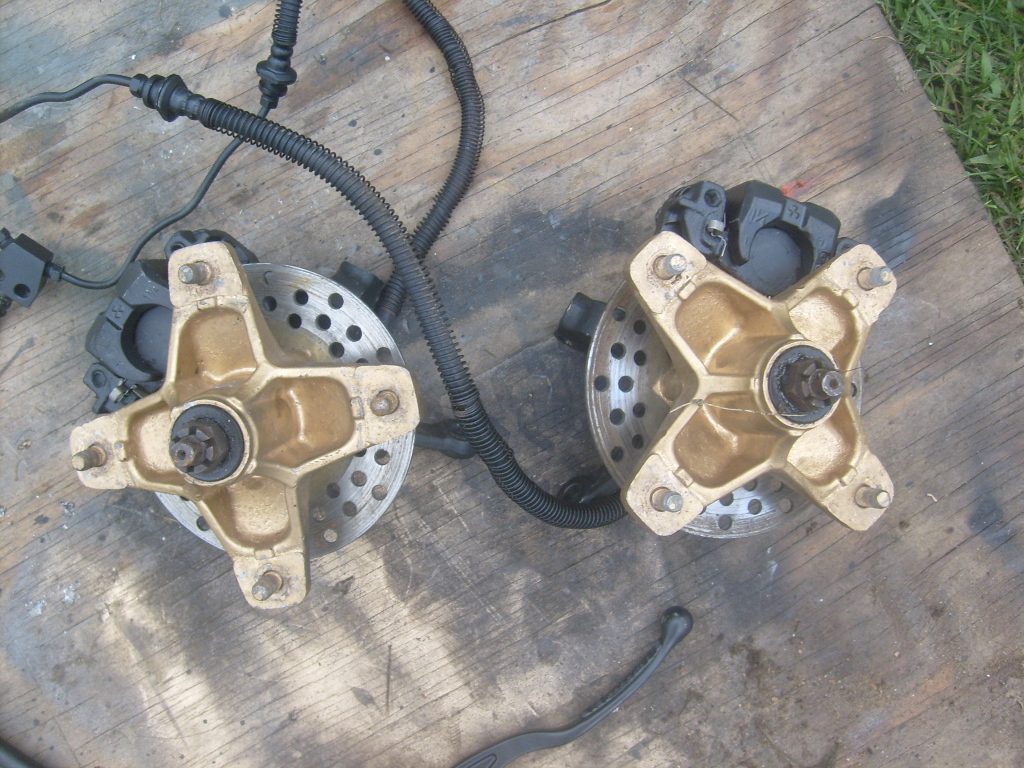

So i have this hydro setup i won.t use,Calipers lines lever and spindles with hubs with BRAND NEW bearings and seals.these puppies are tight.But it will need pads and the caliper plates lined up better to work propper.I need to funds for my top end rebuild.
here they are,the issue was one of the slider pins was frozen causing it to not stay seated at the rotor requiring alot of fluid to operate and the lever was squishy,i tried a known good lever and it was the same.,it is now freed up and lubed.
It will need the tiny rubber boot,other than that everything is here.The lever is a Moose racing lever.
What is a fair price for these setups anyway?This will be goinf toward a total rebuild,bottom to top.

are those stock blaster calipers? it looks like diy welded on caliper mounts
also i just got an idea how to make hydro spindles with some of awks calipers, mount the hub clamp the caliper to the rotor with full holding pressure and weld the mount to the spindle, the caliper should hold strait to the rotor (make sure it clamps the pads where you want the contact area) as always i reccomend no one follow my brain dead fab techniques
