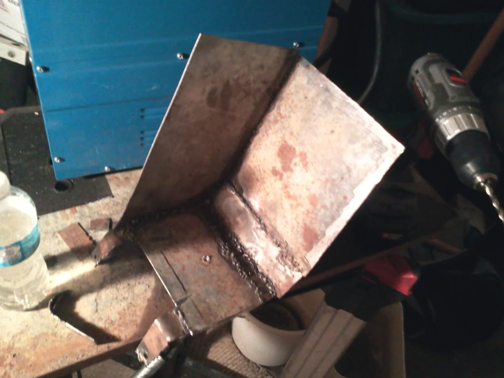

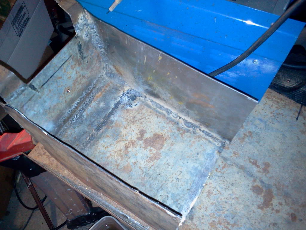

thanks for the advice iv ben up at my grandparents for the past few days ill start back on it again today
oh turn ur voltage up some...... if it adjusts which i would hope it would
I have the same welder, it's almost made just for tacks, it's impossible to bead with it I wouldn't even try what he's doing.
Are you pushing the handpiece toward the work or are you dragging it long.
Conventional welding demands that you keep the weld pool behind the electrode.
Mig welding works better if you feed the wire into the weld pool trying to push it.
. .run a grinding disk over them and reweld, turn the heat up a little and push the handpiece rather than drag it.
The idea is to burn a little and fill the void with filler wire.
Run a grinding disk over them and reweld, turn the heat up a little and push the handpiece rather than drag it.
QUOTE]
ok i cant turn the heat up the only ajustment is for the wire feed
