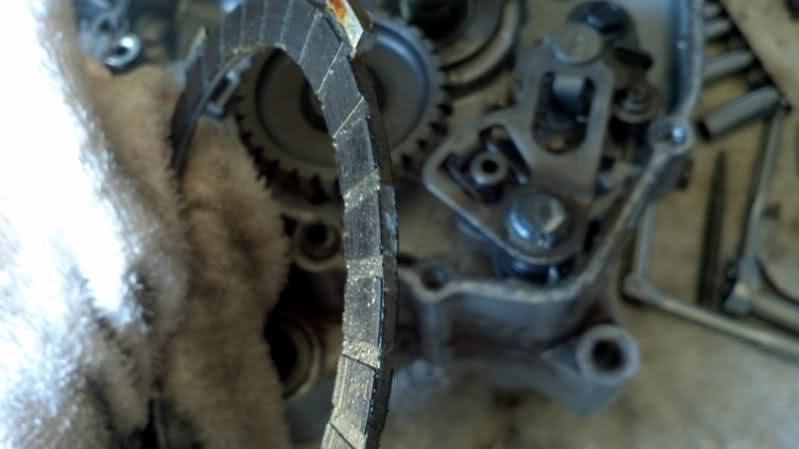

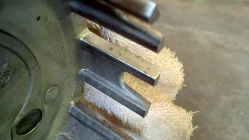

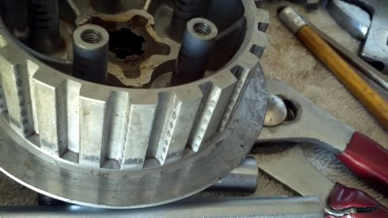

Took a clutch apart to check out a broke off ear tab this afternoon, here it is........

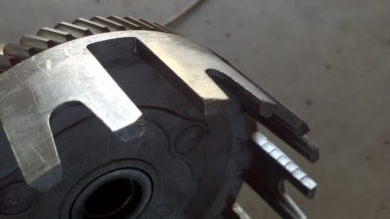

that tab was missing from between these fingers on the basket, looks like a homemade clutchholder did some damage here

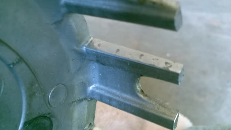

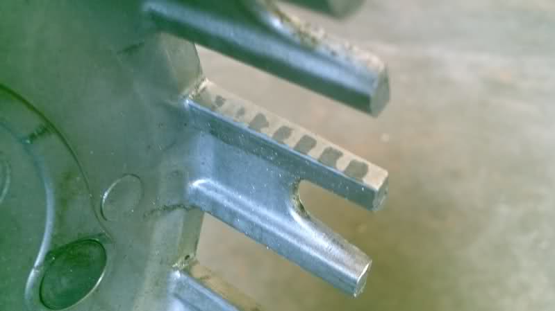

also found some wear on the basket and the inner basket
whats up with the ten pic limit??

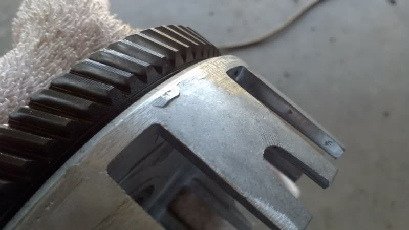

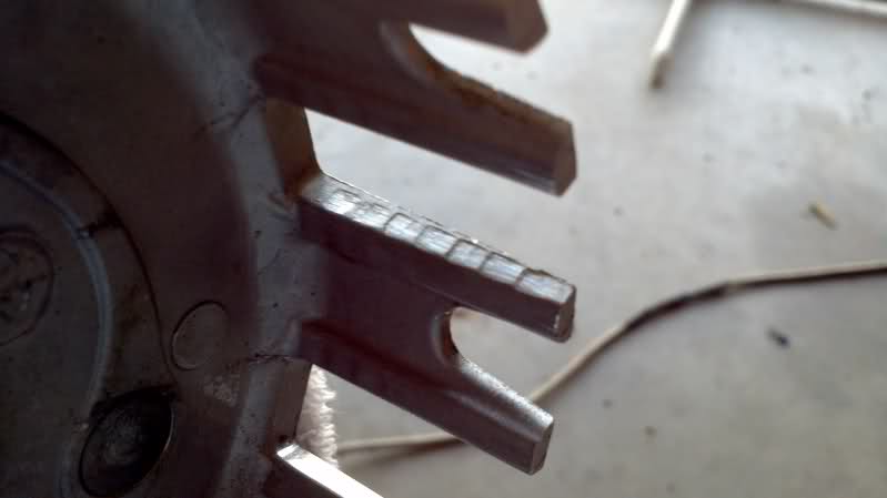

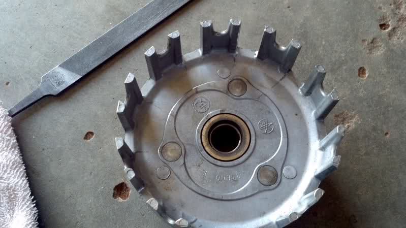

and tried to file out the grooves, and did...

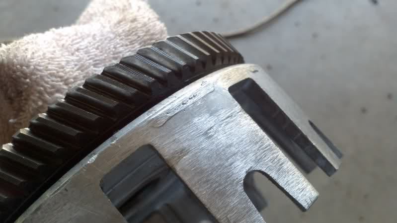

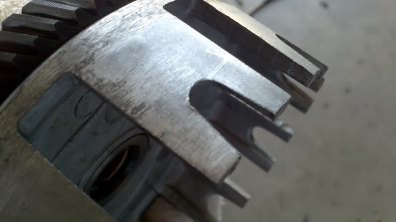

File off some casting roughness,
smoothing off some sharp edges and all done

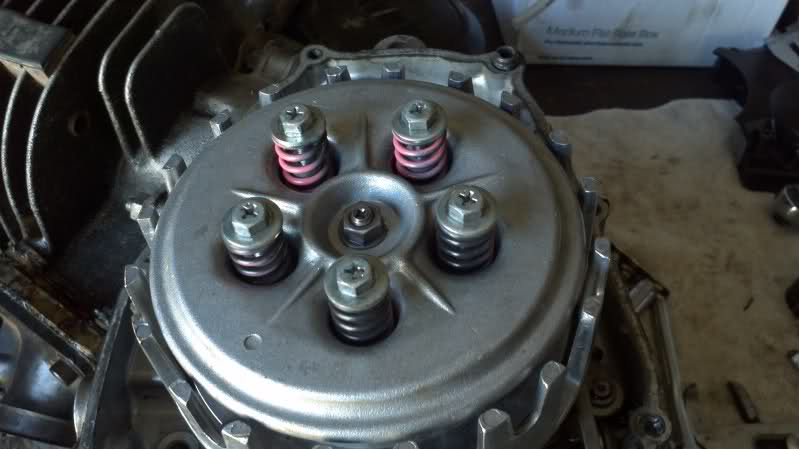

pink springs original???

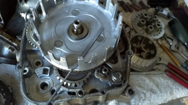

Looks like someone had fun dinking with that clutch before. Unusual to see damage to the inner hub without a bunch of hopups...
Pink painted springs are original. Silly yamaha... who knows what was in their head when they placed the order for their clutch springs...
Reactions: Cheese98
looks very similar to the grooving i found, i didnt know you could file them out ????,
i was going billet basket anyway, tried sanding the inner hub grooves, didnt like the outcome, so got it new also
If the damage isnt very rough you can file them, tho i would always replace it since its a damaged and worn part already.

Those grooves aren't that bad. I have had worse on my bikes it happens to all clutch baskets unless they are made from steel. Filing is a pretty common practice but can't be done more than once on seriously grooved baskets. Your inner hub will be fine. It isn't that bad. Any worse, it should be replaced.
