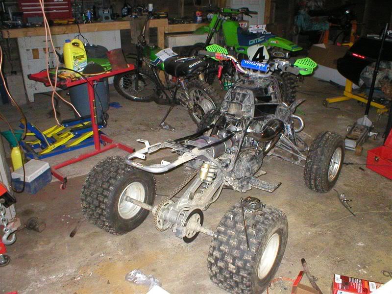

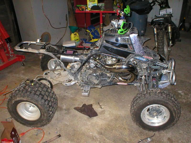

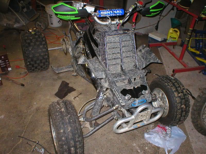

here are some pic of my past shee. maybe my pics will offer up some ideas. I ran the pro design head on mine. just follow the head torque sequence and don't pinch the O-rings or you will be ordering new ones.
And if you buy asr a arms like I did, make sure to use loc tite on the bolts. this happened in the air jumping a big table top. I landed safely due to the track being soft sand.
