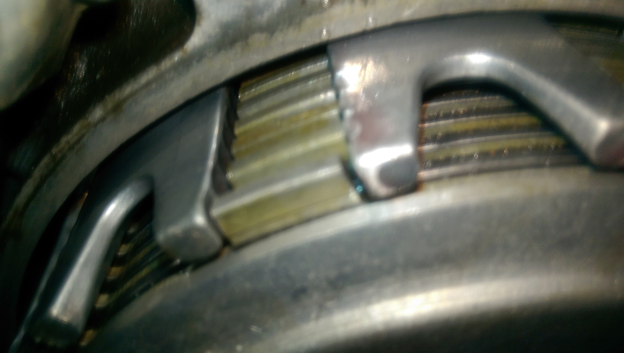

What are the symptoms of a bad clutch basket? Mine has grooves in it, but I don't know if they're more worn in than they should be.
My bike jumps/jerks until I hit the gas. Doesn't matter if I'm at low rpms or flying down a trail, once I let off the gas it "jerks" like the transmission is trying to grab or something until I hit the gas. As soon as I hit the gas, it goes away.
Not real sure what's going on... but I'm thinking maybe it's a worn clutch basket?

Give the basket a file up, it may fix the problems.

post pics of the basket and grooves. they can be filed. but can only be done once than it will require a new basket if they get bad again. i just filed the basket of an RM i am working on now, it was bad. 210 is a good compression for that motor. ive had higher on another bike, but i did need race gas for that. you will be fine to run 93 or better where ever your at.

I'm probably just going to get a new Hinson or Wiseco Billet basket.... but was hoping this would last until the end of the season and I could replace over the winter...
But, the way it's acting, it has to be somethign with the clutch. And considering it's got brand new clutch plates I would have to believe it's the basket. I'm just not sure how bad a "bad" basket is grooved and where mine falls into that category....
Just hoping that this is the problem, cause $200 for a basket isn't cheap!

the basket looks like the one i filed. pull the basket, file the grooved fingers. they dont need to be perfect, but it will help. smooth is what your after. like i said, its a one time repair. because if you file them again, you open the width up causing to much slop. .

I know from research that these oem clutch baskets are garbage and are known for going back FAST, who knows if this is the original basket? I think rather than shaving it down I'd rather just get a new Billet basket and know that it's good to go and know that I won't have to replace it for a really long time, if ever.
