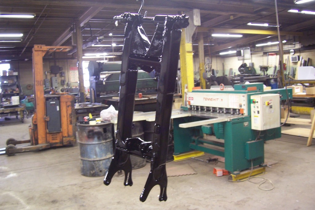

experimental swingarm!!!

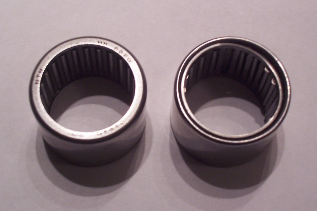

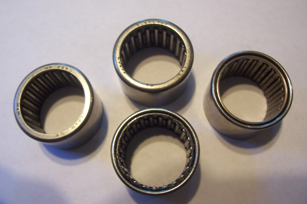

I killed my new bearings, the All Balls swingarm bearing are junk compared to the factory bearings.. the left is a used factory bearing and the right is a All Balls bearing..
I killed the bearing trying to put the collar in.. The Swingarm front pivots are EGG SHAPED :eek: from tig welding a block on for the grease fittings, and the long side is worse from welding the gusset to it.. I had no problem pressing the bearing in to the pivots because they flexed to the egg shape. The collar on the short side was a tight fit, and the collar on the long side just killed the bearing..:(

With the swingarm on the table the pivot tubes are about .005 large up to down and about .005 small left to right. I did not like looking at the ugly factory welds that held the pivot tubes on the swingarm so i HAD to go over them with the tig and some filler to make them look better.. That did not help!!!
When i welded the arm i just did a short spot at a time to keep the heat down and to help prevent distorting or twisting.. That did not help the pivots!!!
The bearings from MSC fit in the swingarm great. I ran a adjustable reamer through the pivot tubes until i got the size that i thought may work or may be a bit tight, next i put in a old factory bearing in then started to put the collar in, but it felt to tight so i took the bearing back out, and gave the adjustable reamer about 1/4 turn then ran it back through, then put the bearing back in and then i put the collar in. BUT the collar was very hard to spin in the bearing so i took the collar and bearing back out, gave the adjustable reamer about 1/4 turn then put the bearing and collar in and the collar spins fine now..........

I trashed the paint job on the swingarm from clamping it to the table to run the reamer through and handling it so much with fresh paint.. But that is ok, i'm going to put it on to see if it will fit right, and make some thing to zip tie the brake line and E-brake cable to, like a thin rod raised off the arm on the right side about 8" long, and weld it on. Then i will take it off and put some new paint on it..

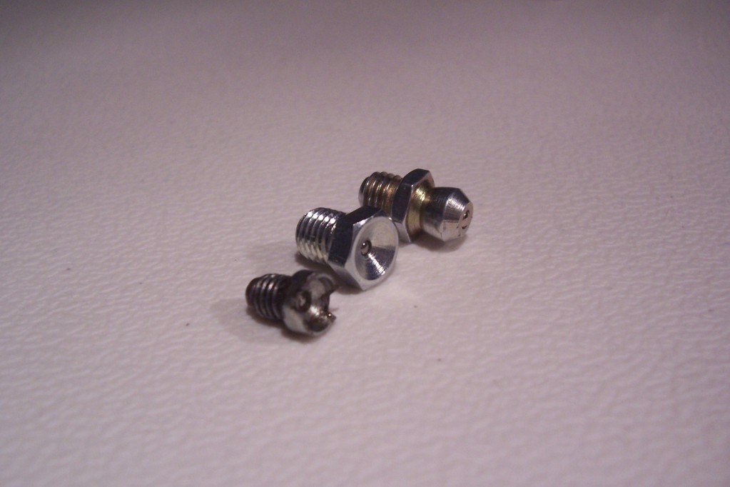

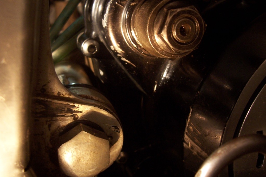

I had the swingarm on my blaster and it fit good, and i welded a piece of angle to it so i can ziptie the brake line and E-brake cable to hold them in place. I also had a problem with the grease fitting on the right side. The grease fitting will just hit the clutch cover when the suspension is collapsed all they way down just before my air box hits my swingarm.. Do i have to go that low?? I dont know?? But i was prepared for this with some shorter grease fitting.. The paint was trashed so i sanded it and put some new paint on it..
Can you see the spot under the bolt on the clutch cover where the grease fitting hit!

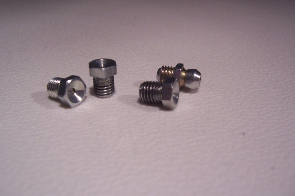

The top right grease fitting is the old one and the other 3 are the shorter grease fittings
The bottom grease fitting is a VERY very VERY small grease fitting i got out of a old broken CV joint from my bronco. It wont fit because it has 1/8" NPTF thread, and my swingarm has 1/4"-28 thread.
New paint!!
