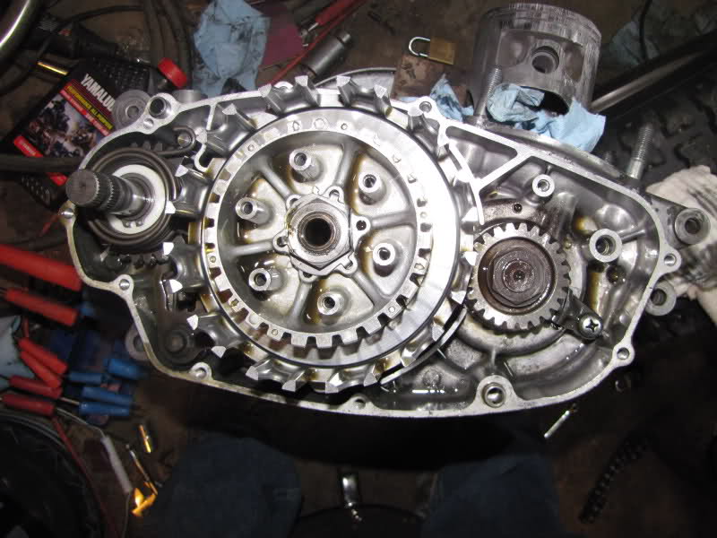

Wow didnt realize how long its been for an update lol. Well I took the clutch cover off and found this. It looked to be in really good condition.

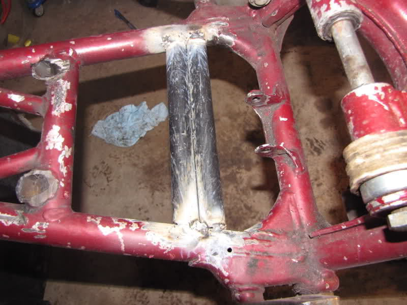

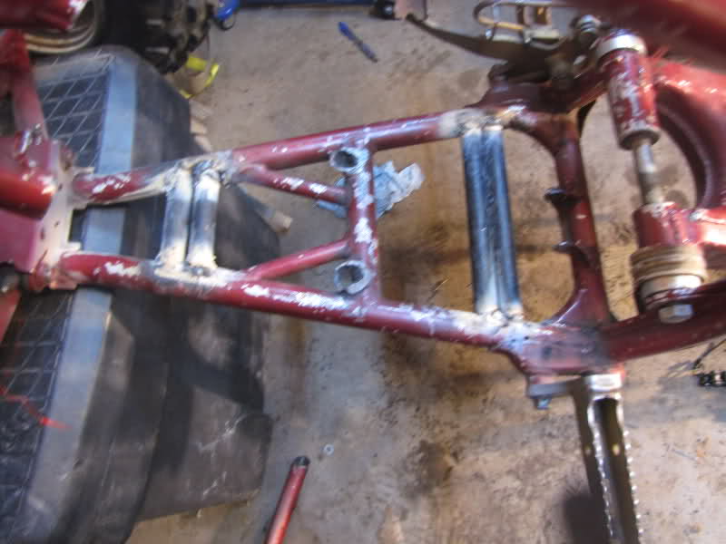

Then I finally got around to working on the motor mounts a little bit.

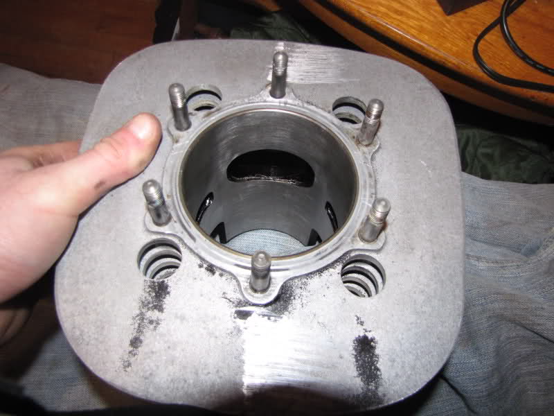

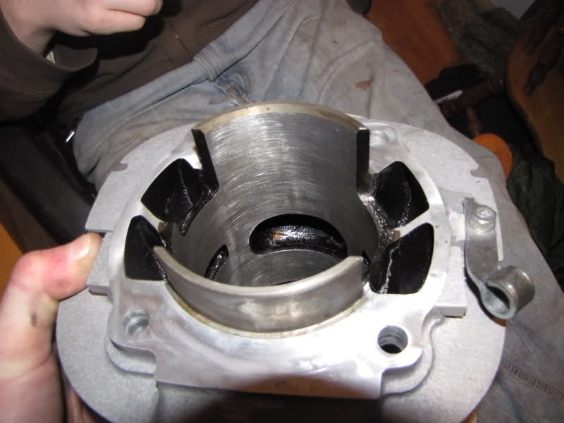

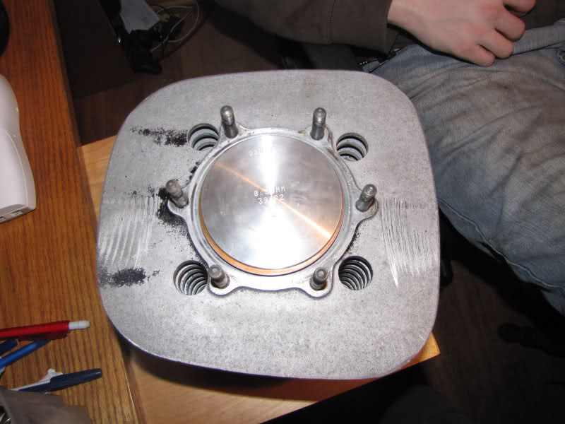

And then the machine shop finally got back to me and returned this to me.

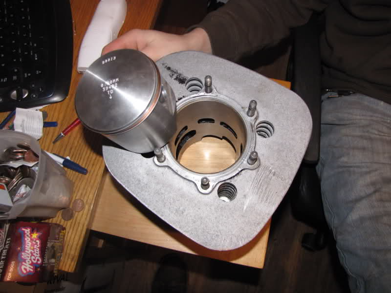

Oh can someone please help me with my piston install? I dont know which way the arrow on the piston is supposed to be facing inside the jug.

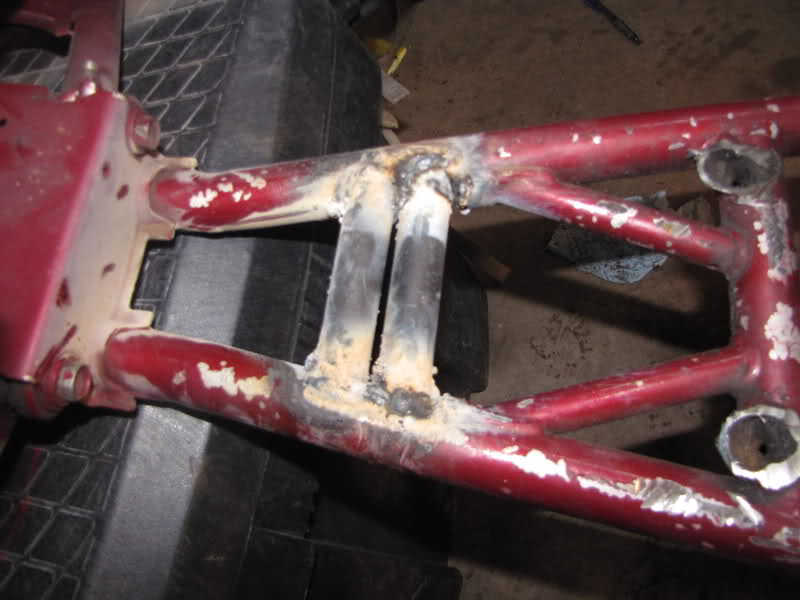

it was a small flux core mig welder. i know im not the best at welding. just started learning a few weeks ago. thanks for letting me know about the arrow on the piston.
your sayin the white powder is from the flux core?
yeah i need to practice a little cause im goin to be goin to a tech school for a 48 week welding class in july. Thanks yb and 92
dude if you can lay a decent bead with that flux core you'll be really happy when you use a real mig with shielding gas. looking good so far tho man
yeah man im tryin my hardest to get some good beads goin with the fluxcore. i picked that little welder up for 50 bucks so I cant complain. I think everything will turn out good though in the end. Im goin to start on the gussets and the front mounts tomorrow and see how that goes.
yeah its definitely harder to lay down a good looking bead, but its doable. i need to get the real mig my dad has up and running so i can get working on suspension pieces

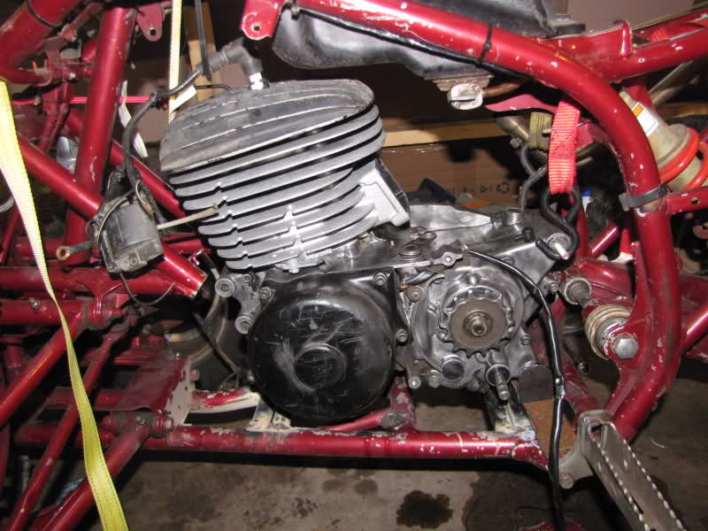

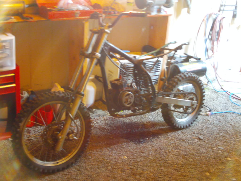

Got the motor placed up in the bike to see how it looks.

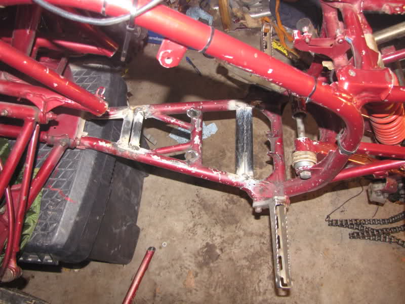

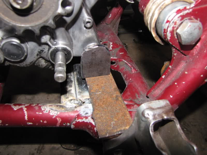

Heres how the back motor mount is goin to look. I decided to go with a piece of 1/4 in plate steel instead of the pipe to mount the gussets to for increased support.

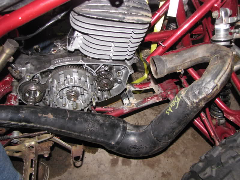

And I finally got the exhaust pipe in the mail. And now i will have absolutely no clue as to how I will get this to fit in the bike.
im thinking about chopping the whole front area where it starts turning and getting an exhaust shop to bend something up for me.
paulie has been helping me every step of the way so far. I hoping to have it runing by this weekend if I can work that pipe in there.
