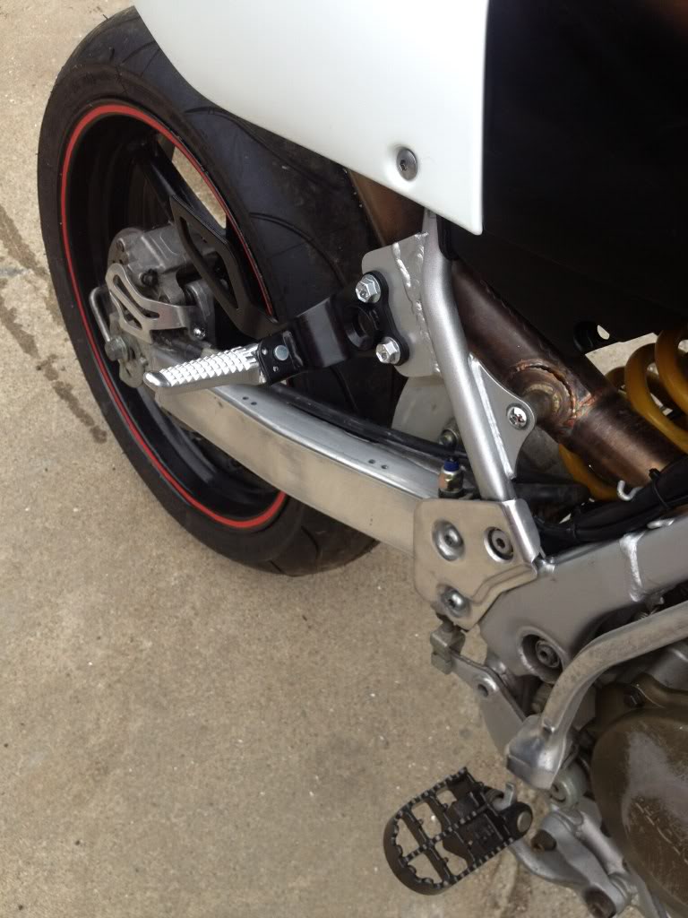

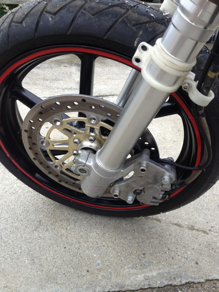

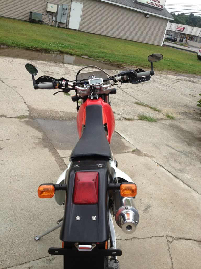

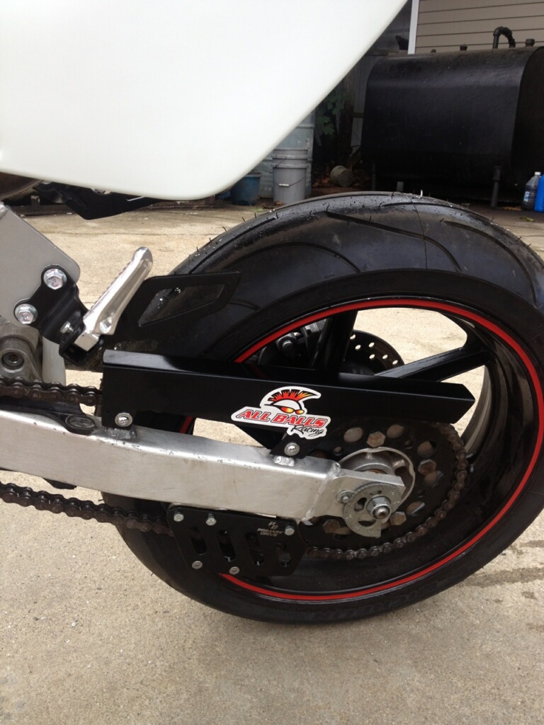

Slight change of plans. After taking a look at the cost to make the XR500 street legal, I started looking for other options. I ended up picking up an XR400 10 days ago. Tarmo, myself, and Ron Bushy started cutting, welding, wiring and tuning. Here’s what we ended up with.
CBR rims, brakes and tires mounted to the XR frame.
Baja Designs turn signals and front plate.
Pro circuit pipe.
New shift lever and foot pegs
Acerbis front fender, side panels and rear fender. I’m running the black for inspection but have a new white one I’m installing after the DMV cops inspect it.
GS 750 key switch. This was a very cool mod. The bike won’t start without a key and once you turn it on, all the lights work. Thanks Tarmo!!!!!!
Battery mounted in the air box.
DRZ 400 rear foot pegs.
Bar end mounted mirrors.
Vapor speedo and tach.
Brand new Michelin tires.
I plan on building the stock engine over the winter. I just want to get some riding in before the winter hits. I’m thinking a big bore, stroker 465 build. I’m taking it to the DMV on Wednesday to get it registered. The rules for getting a dirt bike registered in CT are pretty tight but I think we have it figured out. The rear fender extension is a requirement in CT. 14” from the center of the axle to the bottom of the fender. Looks gay as hell but we’re working on it. The reflectors are also a requirement. More stupid looking crap but it will keep the law off my ass. The Pro Circuit exhaust is also going to be sketchy. The tag said “off road use only”. We drilled the tag off and Tarmo made me a custom exhaust plug. It looks factory and quiets the bike down quite a bit. I’ll be tossing it in the trash as soon as we get done with inspection. I’m stupid busy so the wife sent pics to Awk to post. Thanks Awk!
