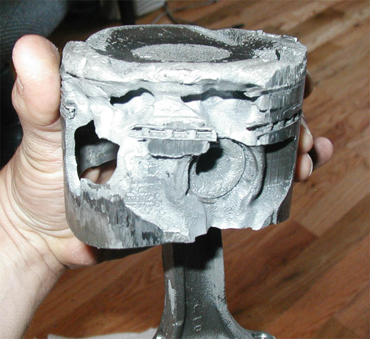

without going into a longwinded explanation for why you shouldnt do this, i will just give you a warning your about to end up with a 3/8" diameter hole on the top of your piston if you keep running that plug

i realize theres still some space there but less trapped volume a concentrated heat source and spark close to the piston crown top is asking for *detonation* ,this is trouble brewing especially on pump gas as it will burn at a much faster rate and create more heat than high octane race blends if yo uwant more compression machine the head and do it right ..trust me theres a valid reason they recommend a NGK B8ES and not any old automotive plug found at walmart
You are making one giant hotspot in the combustion chamber.
yeah, hot spots are bad umkay=))

well i tore it down to do a little more porting and headwork, the piston looked fine, the bottom side of the dome is a little more brown than it was before when running the ngk, but not by much. i put the ngk back in for safety sake cause i milled the head some more when i was playin with the squishband and combustion chamber.
