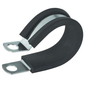

Other option could be P clamps like this.
Those rubber lined clamps are great, I'm using them for brake line and rad hose tie downs. However, they're pretty thin and easily bent. It wouldn't be a problem in this case though.
Those first mounts you shown would be easy easy easy to make. Grab some steel stock, a 1" wood dowel or anything round in 1" and bend some up. Then drill a hole and weld the nut. If you don't have a welder you could go to any exhaust place to do it.
