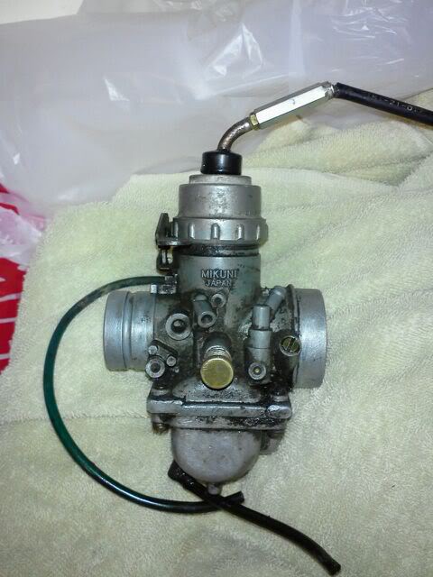

So tonight I tore my carb apart, basically because I was bored and had never attempted a carb tear down before. I was also curious about all these people talking about main jet sizes and pilot sizes. :-/ Now, I'll admit openly, I carb-tarded....but I'm learning, very slowly. I did a bunch of reading, and I'm still clueless...so now I'm asking the questions. And of course, I graciously and humbly thank you for your knowledge and wisdom. I:I
So, I have a 28mm Mikuni VM. Here she is:
When I did some disassembly tonight, I saw that I have a #150 Main Jet...and I couldn't read what I am assuming is the Pilot. I will take pics tomorrow of it cracked open again, I just want to know what I'm tinkering with. Also, seeing how I live at 1808' Elevation, and ride between that and probably 2000', should I rejet? Take me to carb school fellas, just go slow and be gentle with the terminology...lay the sarcasm on as thick as you like.

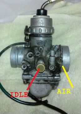

I will see about the pilot #, it was pretty hard to read. To measure the float height, I need that "cork" with the tube on it right? And just to refresh my memory, which is the airscrew? Is that what is commonly known as the idle screw?
no, the airscrew and idle screw are 2 seperate screws and perform 2 different tasks
the airscrew usually starts set at 1.5 turns out, it adjusts air to the pilot jet circut, and it's final setting helps determine if you have the correct pilot jet
the airscrew gets adjusted to where the engine idles the highest, starting at 1.5 turns out, adjust it 1/2 turns and give it 20-30 seconds for the engine to react to that change
turn it in to 1/2 turn, and out to 3+ turns, and keep track of where your at, the setting that it idles the highest, tells the tale
under a 1/2 turn = larger pilot
over 2-1/2 turns = smaller pilot
then it can be played with at 1/8th turns to acheive good clean crisp revs to 1/2 throttle
once you acheive high idle, the idle screw is used to adjust the rpm's to your desired idle,
that is it's only purpose

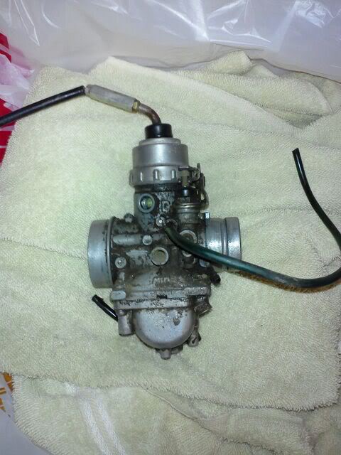

I kinda figured the air screw and idle screw were two different parts, but I just wanted to make sure. Now I just have to figure out what my air screw is on the carb...I think I know, but I'm not 100% and being at work now I can't see my pics.
Well, luckily my carb can drop a nut out the bottom, :eek:, so I think I'm gonna build me a tool. I:I I think before any of this though, I'm gonna hunt around and see if I can get a parts breakdown and maybe a manual of my carb. It sucks having to guess at this stuff, and then describe it, and the answers ya get in return are generalizations, mainly because there's no specificity (<--actual word, I looked it up).
I'll give you a shout in a couple days when I get this all worked out. I gotta get a new idle screw for the carb too. I don't know how or why, but it's bent. I tell ya, every little thing on this bike...EVERY little thing, needs to be looked at. X(
