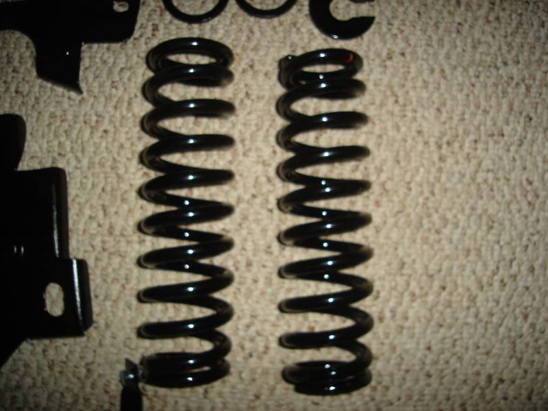

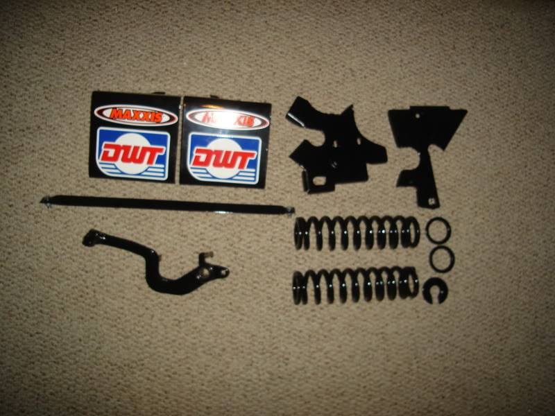

Here are some parts i did for ron89.
The springs were really rusted and the red powder coat was chipping off bad. I think they came out pretty good.

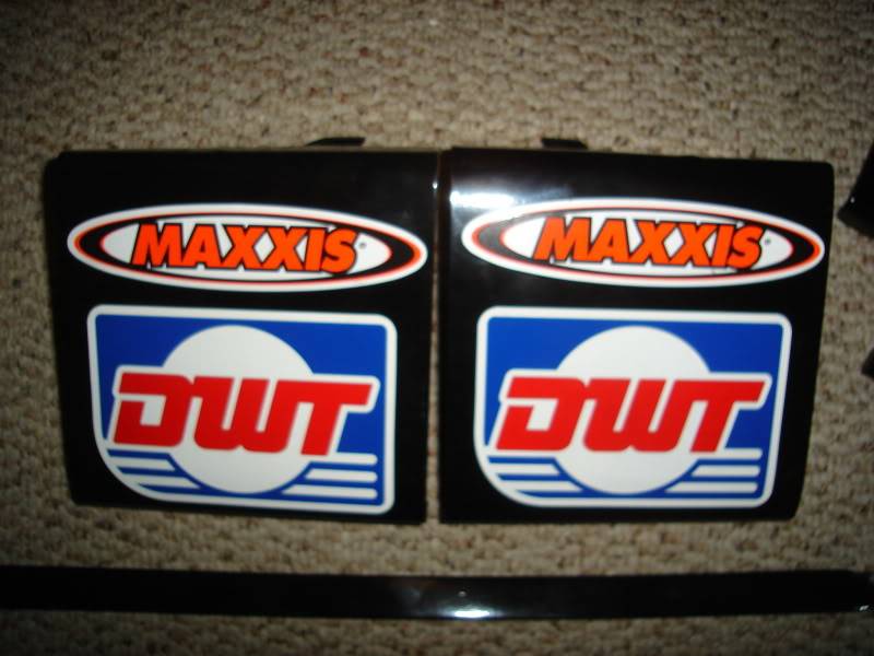

Here are some air scoops I did. Dont worry ron i have the other set, im PCing them tomorrow.
I can do parts about as large as about a DG bumper like mine.
Here are prices for the parts. Prices include return shipping.
Air Scoops (I make and PC for you) $55.00 shipped
Springs $40.00 shipped
PM me for more info and prices.
Pegs $30.00 shipped
You should also add a price for grab bars and exlpain that the buyer has to remove the springs from the shocks. we can also do other small stuff that they may have.

ya you can because thatis where they were hung from. its supe rhard to get a flawless peice that has been powder coated. there is a mark on each spring from where is hung and where the ground clip was.
if its that big of a deal you can just put a drop of touchup paint on there. i just got that idea from my local PC shop.
