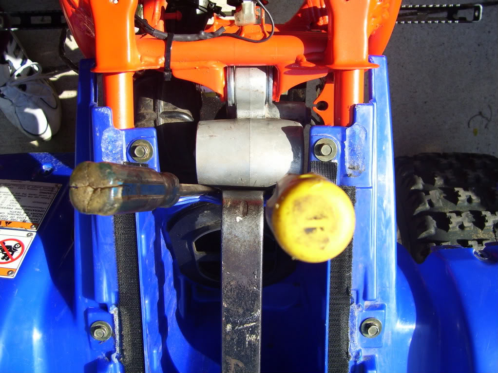

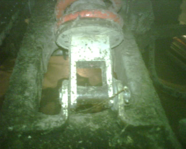

Pics of 400ex shock install
it doesnt need mutch u need to drill the bottm holes of the shock out so the bottom pin can fit then get a diff sleve or drill it out to fit the top bolt in its not that hard to put in
The bearing wasn't in very tight. I just took a piece of wood and it came out without much effort at all. The install is easy if you can use things like a drill and a measuring tape, not much involved to me.
