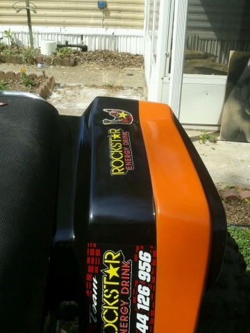

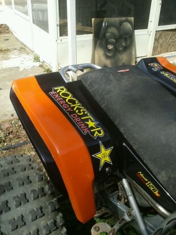

Here are some close ups of some painted plastics. For those of us that like to be different this works great. It does take a lot of time to do it right and make it durable. The paint still looks really good after a year and a half. This bike was rolled at least 3 times and the paint still looks good. The picture in my sig is after the wreck.
