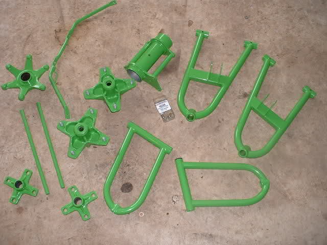

You are correct,but I have had a few axles,sprocket hubs,etc done and they are prone to chip when rocks hit it time after time thats all I am stating.I have had one frame pc'd for almost 2 years and only spots are where the boots rub and that was cleared also.It is deffinately a much better solution to paint as long as the person doesn't mind paying for it.
dunno how much that would be, but i got all of this done for 175
