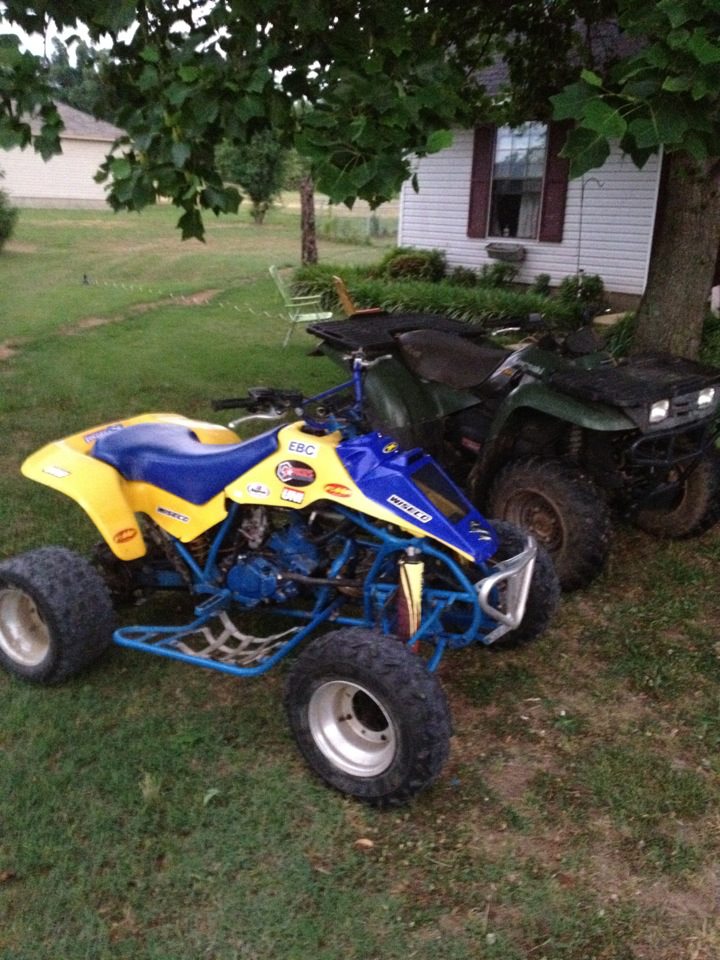

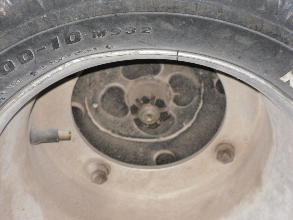

Didn't know a 250r other than a honda existed till a few days ago and now I own one. Don't know a whole lot about em other than what I read in the past few days researching. I think it is a 87 it has the longer shocks, motor mount on head, and painted blue. It does have 4 lug rear wheels though but looks like the same pattern as the fronts.
cool LT, you must have an early 87 if it still has the 4-bolt rears, as late 87 up to 92 had 5-bolt rears.

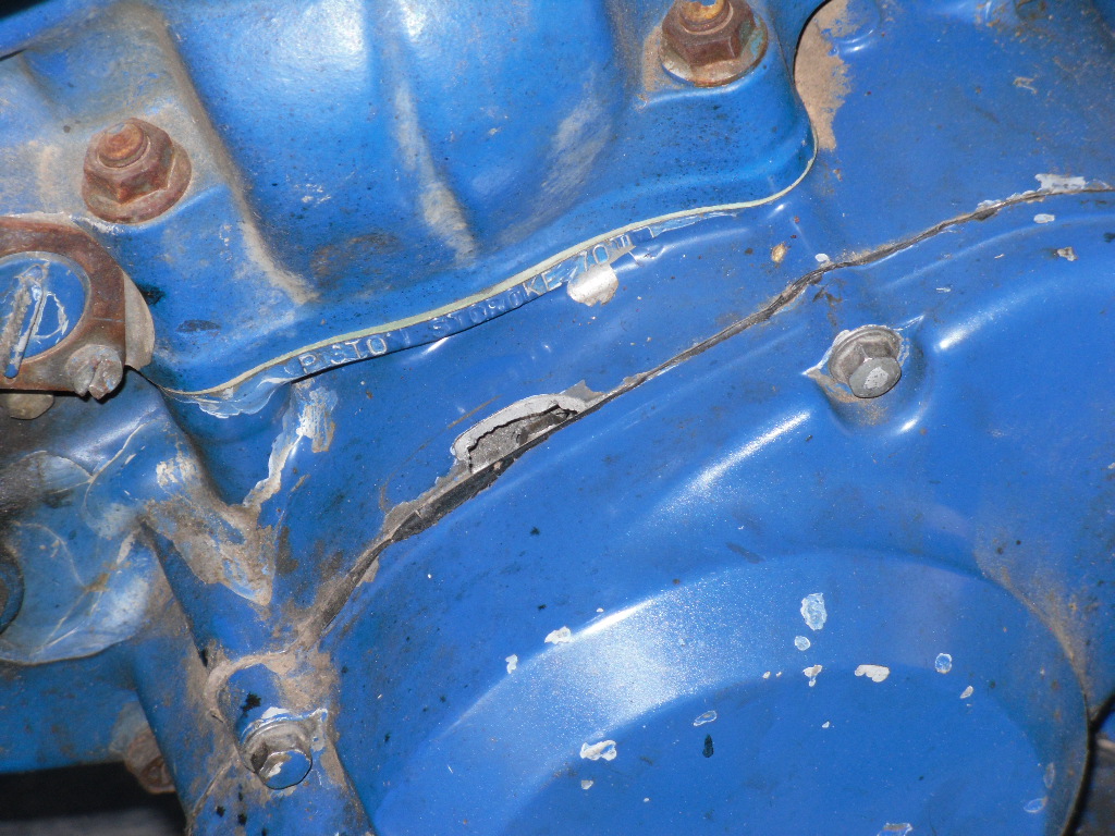

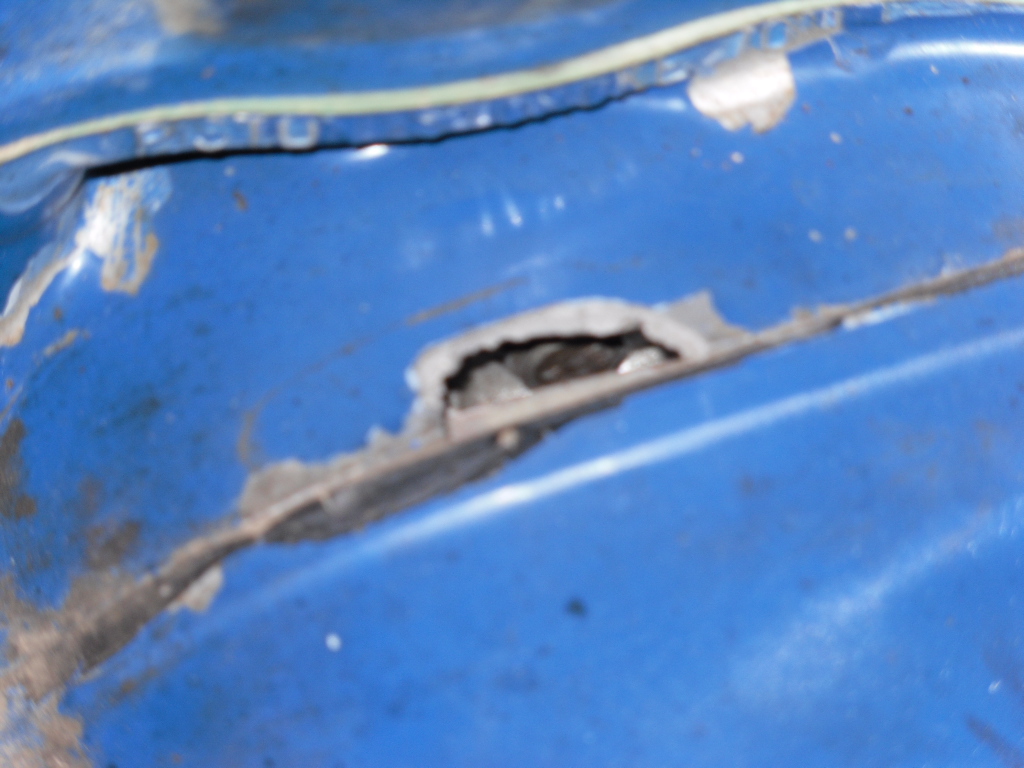

Not sure but I think I just ruined my case.

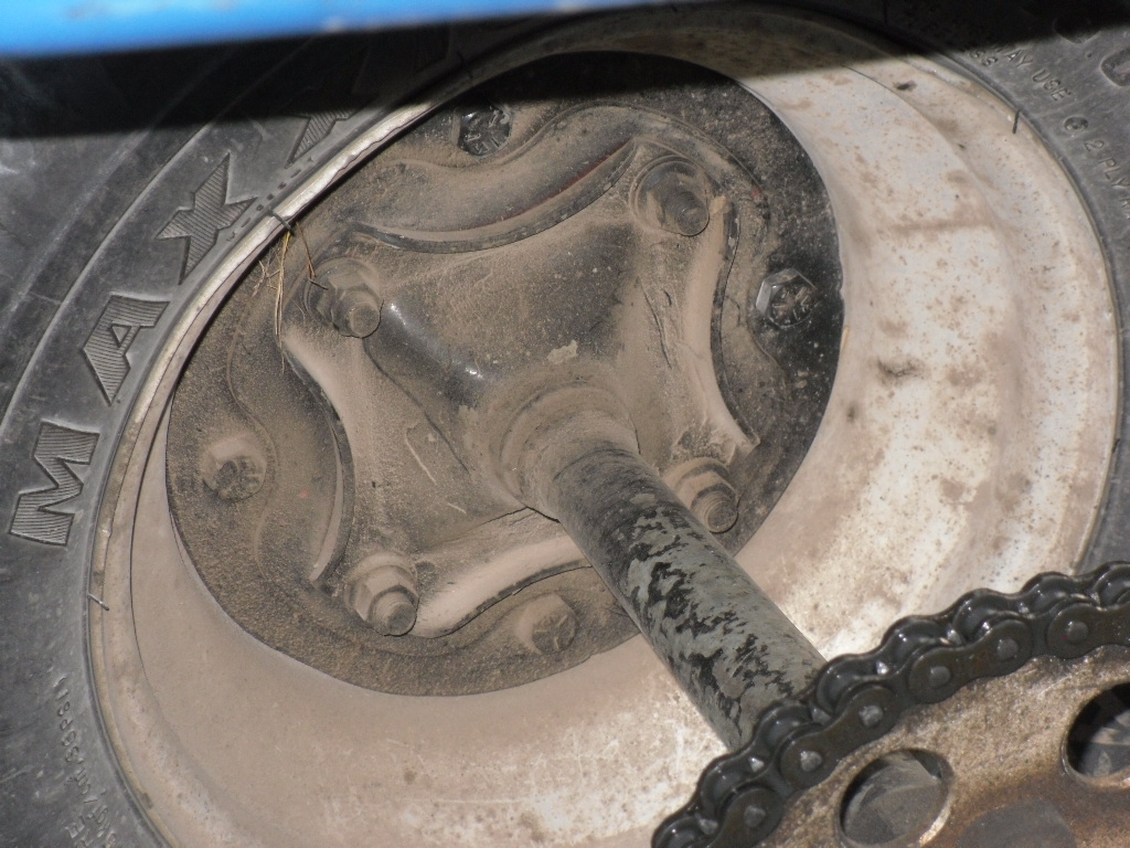

And these are the hubs with some kind of adapter for larger pattern.
so you tried to pry the flywheel off without a puller. lmao. if that is all you did it's fine. fix it with jb weld and keep ridnin
Whatever you did to break the case.. dont do it again.. yes jb weld it... its not a a blaster you cant.mix.n match case sides.. the bearing journals are line bored so two motors are identical.. meaning if you ise mix match sides you will chew up crank bearings...
