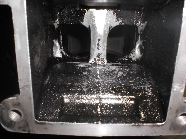

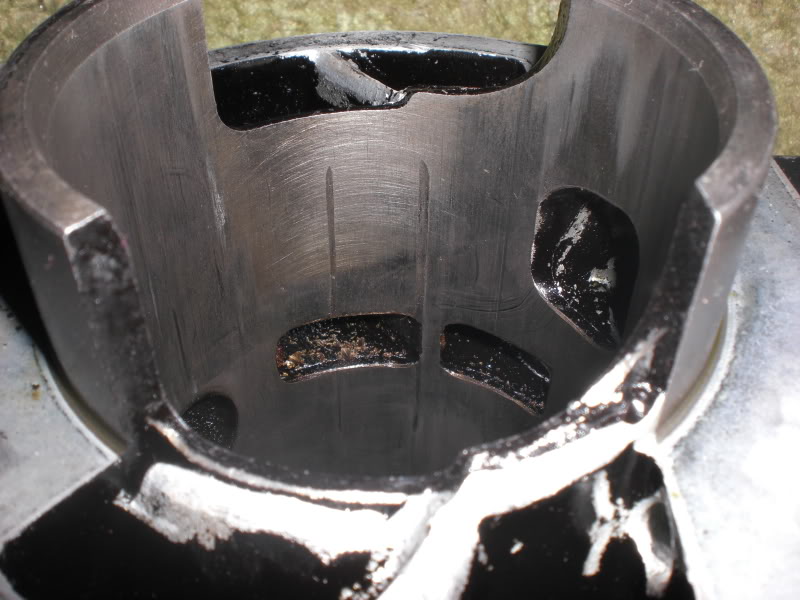

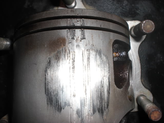

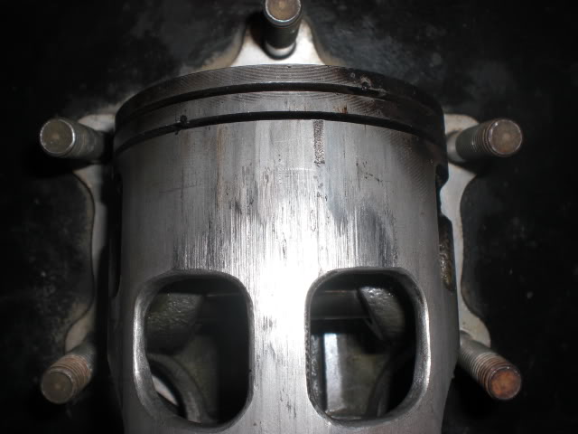

Awhile back when I drilled the boost ports, I left out the wrist pin clips. After i took it for a less then 5 minute ride I came back to see the clips on the shelf. I just about sh*t. Anyway its def time for a bore. My ring gap was .012 over the limit. The piston out of round was .011 which is pretty bad. The scrape it made was .007 alone. Most of the piston damage was from the previous owner probably from no oil. lol I'll probably get quite a bit of lost power back with .040 over.
