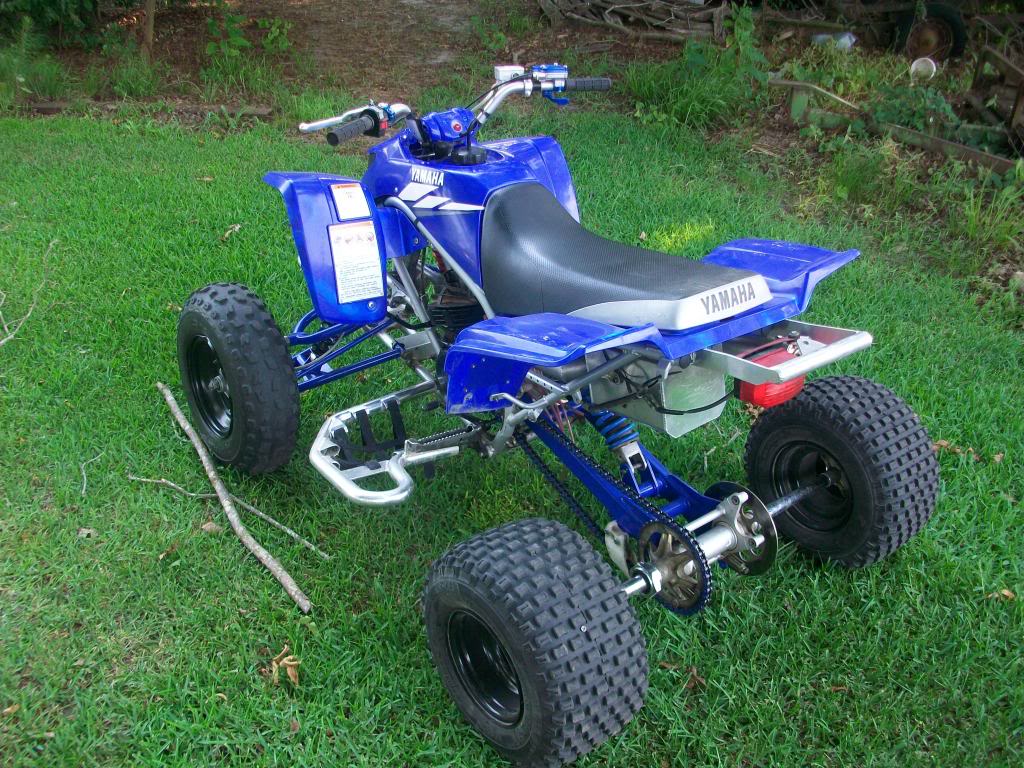

Swingarm: lonestar racing +4 roundhouse
Steering Stem: stock
Stabilizer: stock
Axle : Durablue +2+2
Carrier: JJ&A billet roundhouse dual row bearings
Locknut: Durablue polished by me
Hubs F|R: stock, rear yfz450 (i think)
Bars: renthal
Throttle/Clutch Lever:stock painted by me
Grips: Renthal, oury in waiting
Nerfs: Tusk
Bumper: Ac racing custom painted by me
Grab Bar: Ac racing
Front Shocks: Fox
Rear Shock: 400ex
Brake Lines: streamline steel braided
Rotors F|R: front stock rear saw blade. forgot the brand
Rims F|R: Itp
Tires F|R: holeshots front/ Bandits rear
Body: stock modded
Frame: stock
Plastic: stock modded
Graphics|Seat Cover: stock bc i liked it
Number Backgrounds: NA
Handguards: carbon fiber knucked gloves
Bar Pad: pro taper
Fuel Tank: stock w/banshee petcock
Engine|Drive System: stock ported 3mil
Cylinder|Head: ken oconnor redesigned for 3mil stroker
Bore & Stroke: 67.75 & 60
Displacement: 219 I believe
Cam: replaced with red powerband
Carburetor: Kehin 35mm
Air Filter|Box: factory 7 pollished by me uni dual stage
Pipe|Silencer: Trininty pollished by me
Clutch|Plates: Drive line HD
Gearing F|R: 14/38
CDI|Killswitch: stock/none
Cooling: 70mph winds lol
Other: just look at it. plenty of little custome stuff

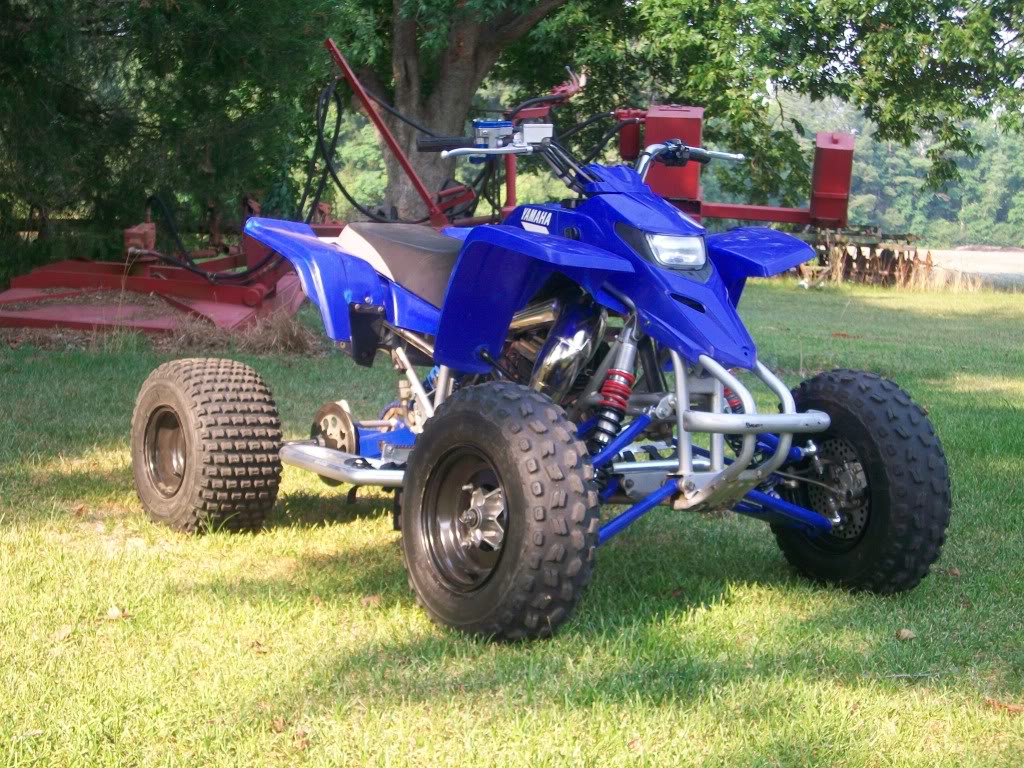

5580-arms-5-1-sms-arms-swingarm-2-chrome-lonestar-racing-steering-stem-warrior-stabilizer-none-axle-banshee-carrier-dual-row-round-house-locknut-anti-fade-lock-nut-hubs-f-r-03-blaster-stock-bars-pro-taper-school-boy-low-throttle-clutch-lever-03-blaster-grips-stock-nerfs-raptor-660-c-bumper-blingstar-iron-cross-grab-bar-svc-front-shocks-yfz-works-lt-triple-rate-shocks-rear-shock-400ex-brake-lines-speedlines-rotors-f-r-03-blaster-rims-f-r-itp-bead-lock-off-set-rims-dwt-red-label-tires-f-r-22x7x10-razr-2s-20x11x8-razrz-body-frame-2003-body-skid-plate-plastic-black-race-front-hood-black-tank-cover-no-rears-graphics-seat-cover-confederate-flag-number-backgrounds-n-handguards-tusk-d-flex-bar-pad-pro-taper-w-compass-watch-fuel-tank-stock-shee-petcock-engine-drive-system-cylinder-head-flotek-aggressive-trail-port-head-mod-bore-stroke-72-25mm-3-mm-displacement-246-cc-reeds-vf3-carburetor-34mm-pj-air-filter-box-cfm-airbox-uni-clamp-filter-pipe-silencer-dyno-port-high-volume-clutch-plates-tusk-gearing-f-r-14t-stock-cdi-killswitch-monster-coil-ngk-plug-wire-pro-amour-tether-kill-switch-cooling-what-ever-im-riding-through-other-gsxr-rear-caliper-set-up-awk08-tusk-gas-cap-go-pro-camera-mounts-handle-bars-bumper-endurance-trail-tech-computer.jpg
A Arms: +5+1 SMS
Swingarm: +2 chrome lonestar racing
Steering Stem: Warrior
Stabilizer: none
Axle: banshee
Carrier: Dual row round house
Locknut: anti-fade lock nut
Hubs F|R: 03 blaster / stock
Bars: Pro taper school boy low
Throttle/Clutch Lever: 03 blaster
Grips: stock
Nerfs: Raptor 660 A/C
Bumper: Blingstar iron cross
Grab Bar: SVC
Front Shocks: YFZ Works LT triple rate shocks
Rear Shock: 400ex
Brake Lines: Speedlines
Rotors F|R: 03 blaster
Rims F|R: ITP bead-lock off set rims / DWT red label
Tires F|R: 22x7x10 RAZR 2's / 20X11X8 razrz
Body:
Frame: 2003 with body skid plate
Plastic: Black race front hood, black tank cover, no rears
Graphics|Seat Cover: Confederate flag
Number Backgrounds: N/A
Handguards: Tusk D-flex
Bar Pad: Pro taper w/ compass&watch
Fuel Tank: stock with shee petcock
Head Light: 50 watt trail tech light
Cylinder|Head: Flotek aggressive trail port and head mod
Bore & Stroke: 72.25mm & +3 mm
Displacement:246 cc
Reeds: VF3
Carburetor: 34mm pj
Air Filter|Box: CFM airbox with uni clamp on filter
Pipe|Silencer: Dyno-port high volume
Clutch|Plates: Tusk
Gearing F|R: 14t|stock
CDI|Killswitch: Monster coil, NGK plug wire and Pro amour tether kill switch
Cooling: what ever im riding through
Other: GSXR rear caliper set up by AWK08, Tusk gas cap, go pro camera mounts on handle bars and bumper, endurance trail tech computer and a bunch of custom shyt

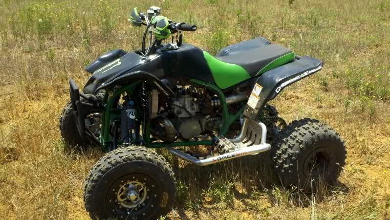

A Arms: ASR +3+1 Long Travel
Swingarm: Swingarm Shop +4
Steering Stem: Stock
Stabilizer: N/A
Axle : G-Force Adjustable
Carrier: Stock
Locknut: G-Force
Hubs F|R: Banshee Front / Stock Rear
Bars: Stock
Throttle/Clutch Lever: Stock PC'd Blue / MSR AOF
Grips: Scott Hurricane
Nerfs: Tusk
Bumper: Stock
Grab Bar: A/M (not sure?)
Front Shocks: Works Triple Rate YFZ450
Rear Shock: ATC 250r
Brake Lines: Polaris Predator Fronts
Rotors F|R: Banshee Front
Rims F|R: Stock
Tires F|R: Stock / 18" Turf Tamer
Body:
Frame: Stock
Plastic: Stock
Graphics|Seat Cover: Stock
Handguards: N/a
Bar Pad: N/A
Fuel Tank: Stock
Cylinder|Head: Ken O'Connor ported / Ken O'Connor redesigned
Bore & Stroke: 67mm / Stock Stroke
Displacement: 195cc
Reeds: Boyesen Dual Stage
Carburetor: Keihin 35mm Airstriker
Air Filter|Box: UNI / CFM Alum Box
Pipe|Silencer: Trinity Racing
Clutch|Plates: Stock / Stock
Gearing F|R: 14/40
CDI|Killswitch: Stock / Stock
Cooling: Air Cooled
Other: Gotta HotRodz +4 waiting to be finished...

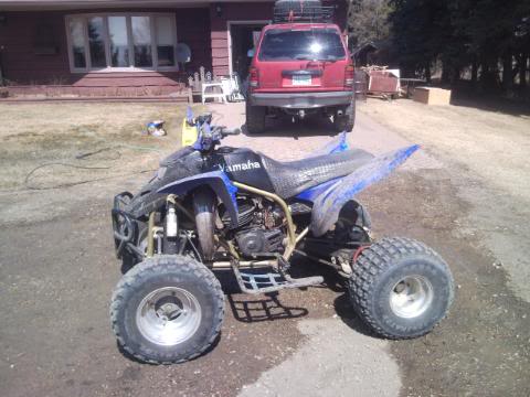

A Arms: stock with diamond j +6 widening kit
Swingarm: +3 extended f7
Steering Stem: stock i think
Stabilizer: none
Axle : gforce adjustable axle
Carrier: gforce
Locknut: gforce
Hubs F|R: hydraulic/yfz450
Bars: renthal
Throttle/Clutch Lever: stock/stock
Grips: scott grips
Nerfs: tusk
Bumper: ac
Grab Bar: baja rear grab bar
Front Shocks: yfz450
Rear Shock: modded rear
Brake Lines: stell braided
Rotors F|R: stock
Rims F|R: itp/itp baja
Tires F|R: itp holeshot/r/a shredder
Body: maier race front hood/cut rear fenders
Frame: stock and fully gusseted
Plastic: maier race hood
Graphics|Seat Cover: none but stickers/05 seat cover
Number Backgrounds: custom on the front hood
Handguards: acerbid
Bar Pad: outlaw
Fuel Tank: stock
Cylinder|Head: vitos 240 bbk
Carburetor: keihn 35mm pwk
Air Filter|Box: twin air filter/sms aluminum airbox
Pipe|Silencer: fmf all the way
Clutch|Plates: barnett dirt digger clutch/trenga racing side cover
Gearing F|R: 13/43
coil|Killswitch: aftermarket coil/pro design killswitch
Cooling: air
Other:18 rear tires doughlas rims and pro circuit exhaust/works shocks/banshee axle/trenga racing hydraulic rear brake/fox racing air shrouds and oil injection delete/trenga cylinder/sms manifold reed spacer/boyessen pro series reeds/scary fast not installed/baja skid plate front and rear monster shock covers on the way fully gusseted frame.

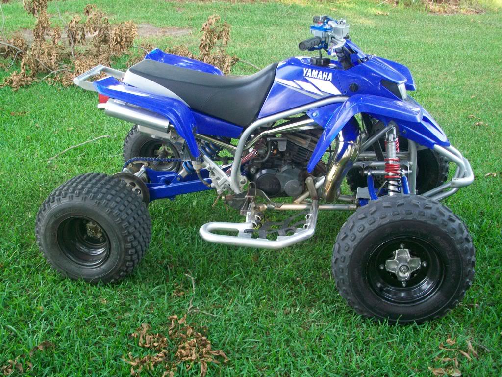

A Arms: Chasis Fab +4 up 1 Max ground clearance long travel
Swingarm: stocker for now soon +3 chasis fab
Steering Stem: my own +2 anti-vibe stem with lonestar antivibe clamp
Stabilizer: none
Axle : durablue 2+2 adjustable
Carrier: jjandaracing black anodized
Locknut: durablue
Hubs F|R: Lonestar YFZ billet front hubs/yfz
Bars: Flexx Bars
Throttle/Clutch Lever: ASV F3 shorty's black anodized
Grips: ODI rogue grips
Nerfs: Racesin with integrated heelguards
Grab Bar: my own made
Front Shocks: Fox float X evols yfz long travel
Rear Shock: Elka elite stage 4
Brake Lines: streamline dual performance lines
Rotors F|R: yfz typoon front rotors, blaster typoon rear
Rims F|R: Hiper tech 3 single beadlock/ Hiper tech 3 dual beadlocks
Tires F|R: 19x6x10 itp holeshot mxr6/ 18x10x8 itp holeshot mxr6
Body:
Frame: modified frame for yz 250 motor/gusseted
Plastic: Taurus project blaster V1 hood
Graphics|Seat Cover: green and black gripper
Number Backgrounds: none
Handguards: Powermadd green and black
Bar Pad: Flexx green bar pad
Fuel Tank: stock w/yz 250 petcock
Bore & Stroke:
Displacement:
Cam: not
Carburetor:38mm keihin
Air Filter|Box: UNI filter w/outerwears....modified CFM aluminum airbox
Pipe|Silencer: FMF gold series headpipe/ DPM carbon fiber silencer
Clutch|Plates: stock
Gearing F|R: 14/40
CDI|Killswitch: pro armor kill switch
Cooling: yfz 450 radiator
Other: yfz 450 brakes front and rear, Vf2 reeds, alba racing billet gas cap

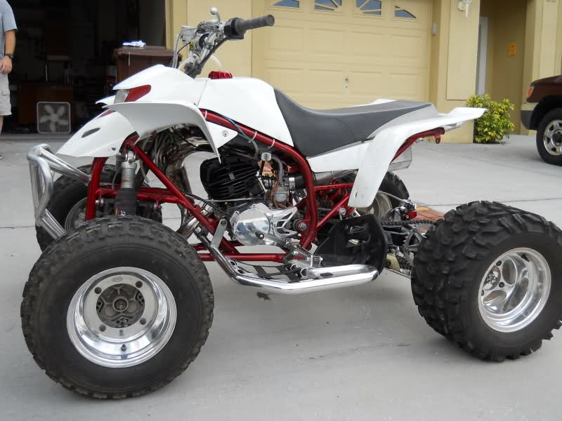

A Arms: Stroked Tater +1.5" A-Arms
Swingarm: Stroked Tater +3.5" swinger
Steering Stem: Yamaha
Stabilizer: none
Axle : Banshee
Carrier: Custom grinded
Locknut: Yamaha
Hubs F|R: Painted Yamaha
Bars: Moose Racing
Throttle/Clutch Lever: MSR Shorty levers
Grips: Pillowtops!
Nerfs: DG Steel
Bumper: Blingstar Victory
Grab Bar: home made
Front Shocks:KFX 450r
Rear Shock: 400EX
Brake Lines: YZ 125
Rotors F|R: Yamaha
Rims F|R: ITP T-9's
Tires F|R: 20" Kenda Dominators
Body:
Frame: Custom Gold
Plastic: Raptor 700r/ Maier Race Plastic
Graphics|Seat Cover: Custom Aligator Skin
Handguards: Acerbis
Bar Pad: Tag
Fuel Tank: Yamaha
Cylinder|Head: Kennedy powersports ported, and Head cut
Bore & Stroke:72mm piston with stock crank
Displacement:240
Cam: not
Carburetor:35mm keihin Airstryker
Air Filter|Box: K&N filter w/outerwears....modified stock airbox
Pipe|Silencer: Vitos Fat Bastard pipe
Gearing F|R: 14/39
CDI|Killswitch: Yamaha
Cooling:Single Scoop
Other: 180 PSI Comression Runs on Race gas
