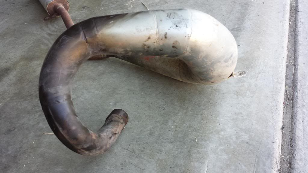

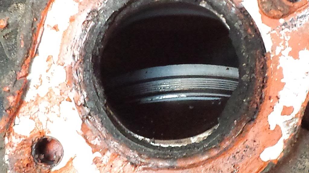

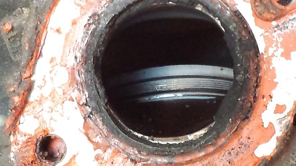

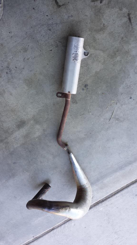

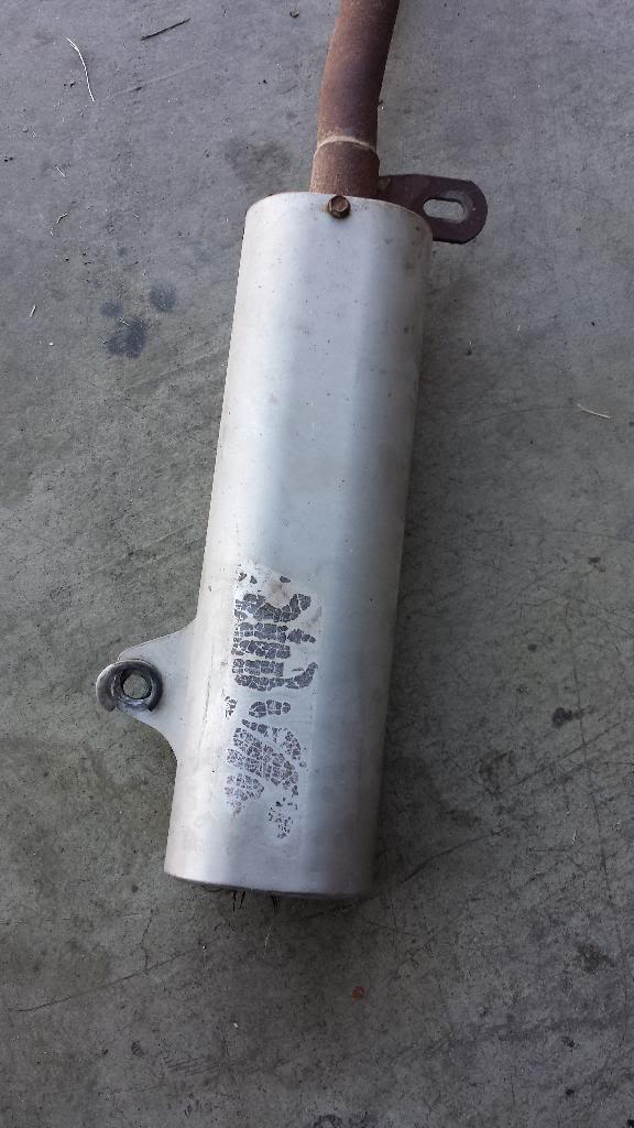

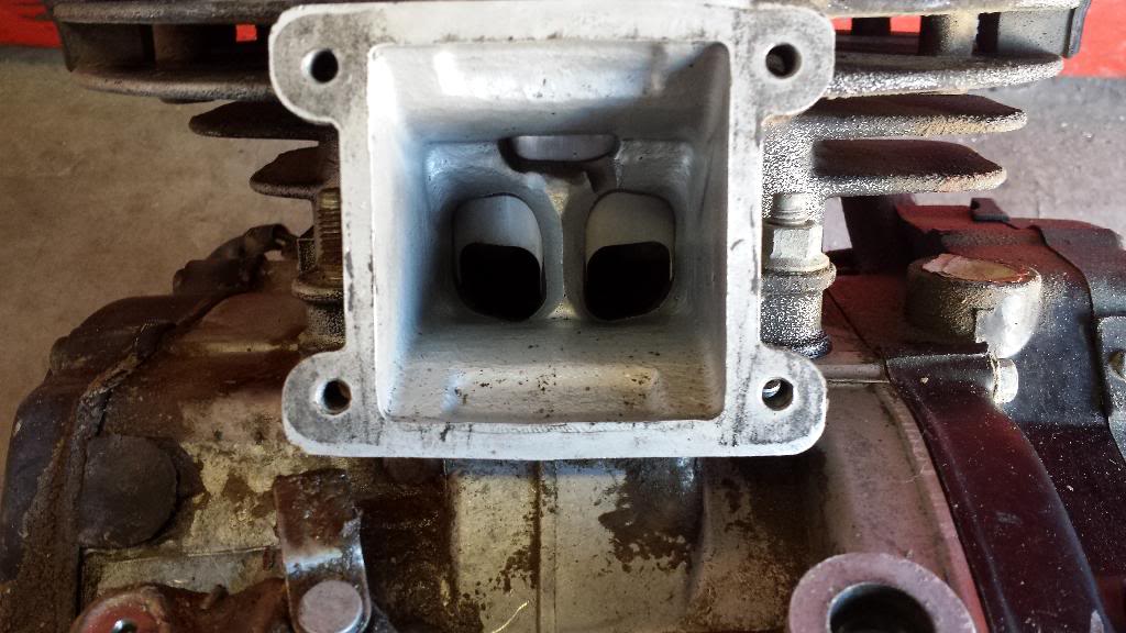

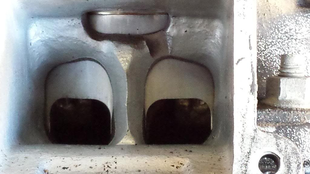

Looking for a little help identifying some parts. I picked up another blaster as a parts machine and it came with a pipe that does not have any identifying marks on it. I am hoping someone here can help me out with figuring out wat it is. The blaster had a PJ cab on it that needs a little work, the slide is a little torn up on the outside of it, the part thet holds the needle in is worn out and it might need a new needle. Anyway, I also found out that the engine aperantly has a port job done to it also. Any idea as to what kind of porting this is, doesnt look like what I would call a trail port. I am starting to think that the stock carb isnt going to cut it...

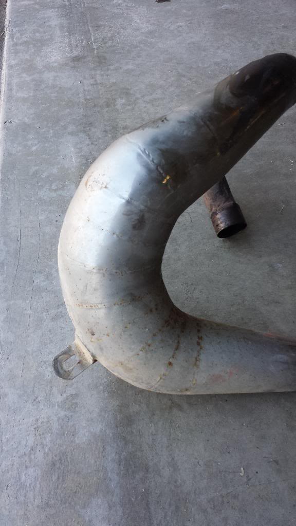

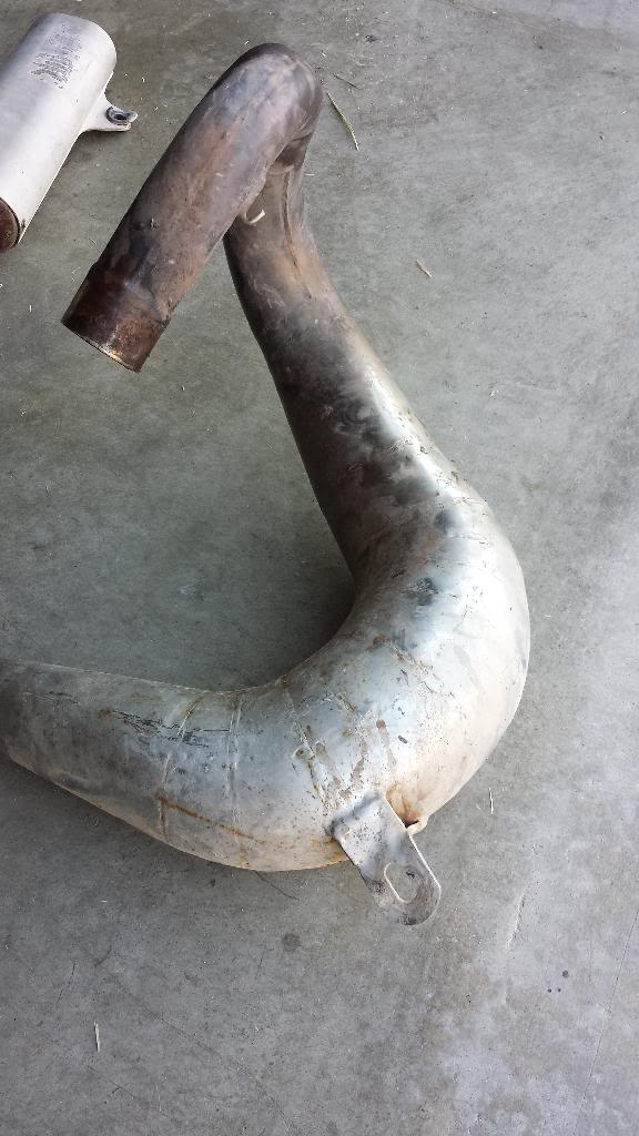

that appears to be an older trinity or graydon proline pipe, i see quite a few individual rolled cones, versus the more stamped pieces of the newer style right bend pipes.
same pipe i run on my white blaster, luv that pipe
silencer ?, could be a DG ?
the porting doesn't appear to be anything overly aggressive, and is lacking the boysen ports.

The stock Mikuni VM26 Carb will work awesome.... and it FITS! Trust me... You want to keep the velocity of the air through the carb high to force feed the crank case when the reeds open. then slam shut. A bigger carb will be harder to tune because of reduced velocity travelling through the carb. With that porting (looks like a decent trail port on the intake side...only part of the "whole") and pipe ,don't forget to bump up the main jets a few sizes. I had to go ten (10) sizes bigger. Was the head "Re-chambered" too?

The silencer looks like a LRD. Looks to be a right bend pipe.
Right bend pipe???

yes, it's a right bend pipe, but not an LRD, i've never seen them with as many individual cones like that has.
some of the early power pro's... remarketed as F7, Trinity, CT and Graydon Proline had those.

yes, it's a right bend pipe, but not an LRD, i've never seen them with as many individual cones like that has. some of the early power pro's... remarketed as F7, Trinity, CT and Graydon Proline had those.
