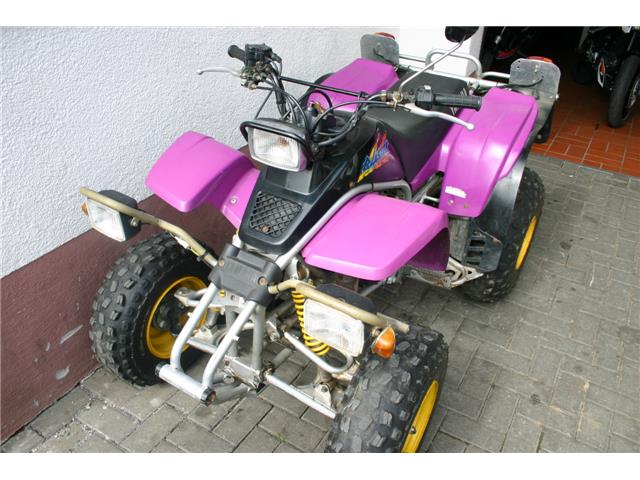

Hello fellow riders,
I bought a used BLaster 1990. The Blaster has non stock additional lighting.
But the lighting wont work. . . I need this lighting to work.
It seems that the stock generator /stator of this 1990 blaster is too weak. Not enough output to power all those bulbs.

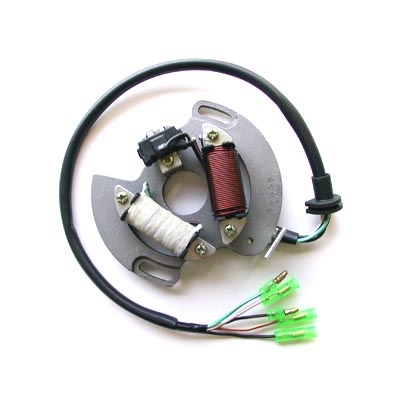

I also found this in an older thread
Here is the link: Ricky Stator - Products!
What do u think?
Whew those lights are ugly! lol. My opinion would be to ditch all the lights on it and convert to LED's.
You will need to Float the ground on that Stator, its a simple job really.
Then the option is to have a Small Battery. I use one out of a Exit sign lol
Then purchase a AC to DC regulator/rectifier to convert the blasters AC current to DC current for the LED's
then wire it all up and your done lol
Thank u jbuckster07 ......
That sounds good to me.
LEDs are the way to go. :)
btw....the stock stator puts out 55 watts max, anything over that will overload it.
I run a 75 watt coil on my stock stator and run 2 35w halogen trailtech lights
