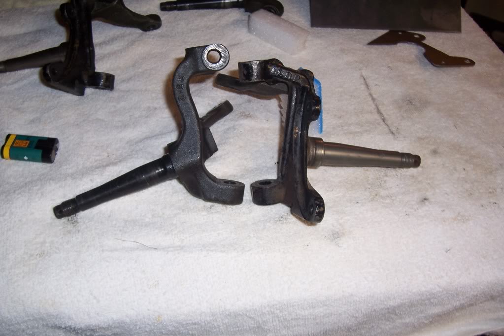

So I'm letting my girl drive my blaster that still has the stock brake setup on it. She's complaining that its hard to stop. I did some reading on the conversion. I am wondering why do you need the KOR spindles? Is the ball stem a different size on a banshee versus a blaster. A banshee spindle and hub won't bolt up to a blaster a arm?
I also assuming if I find a 03+ blaster rear brake setup it will pretty much bolt up to to my 02 with the exception of mounting tabs for the master and rez right?
The KOR spindles are the ONLY bolt on spindles. Banshee spindles can be used with machine work. It's just easier to get the KOR spindles and I feel there more reliable.
