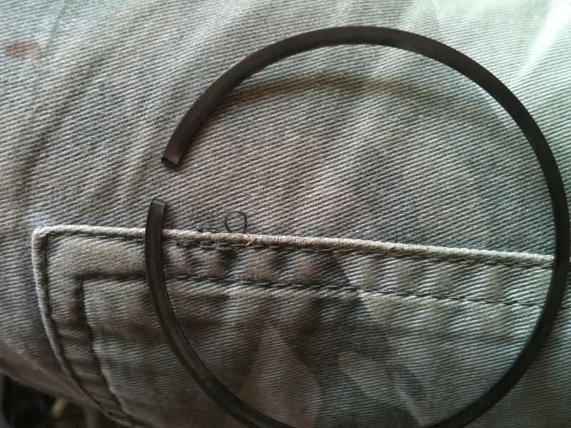

ok so i took the jud, head off, and heres what i found.
what i did notice also was where the rings do seat on the piston, there should be a little bridge rite? like so thtat the gap in the rings is inbetween that bridgle so they dont move? if there is sopose to be a bridge, its not there. only a little stump.
also the rigs were very loose inside the clyinder. they moved around a lot.
It is apparent that the ring positioning pins have been worn out by excessive ring movement.
There are many reasons why this happens, but I am not crossing that bridge.
If it were me I would be tossing out that piston, the ring lands on the piston would have to be worn, to allow enough ring movement to wear the pins out.
Get the jug measured, bored, if it needs it and fit a new piston.
well i think they moved because the piston was too small for the bore. but eaither way ima have to get new pistion. and i think a hone will be good rather then a bore. thers no scratches in it. like im surprised how good it is
You said that the rings were worn unevenly, this could be caused by port snagging.
When you get the jug measured, make sure that you have the areas directly above and below the exhaust port measured well.
Make doubly sure there is not excessive wear there, because it could cause the new rings to snag also.

If no bore is needed that's a plus, but definetly new piston kit! Hopefully cylinder is straight!
i called ken, ima see what he says. but the cylinder walls and everything is in perfect condition. no scratches or anyhting. but i dont know if its stright or wht have you. so i dont need bore unless its not stright. but hone will do if all else is good.
If its just a hone, do it yourself by hand..that way you dont have to send the barrel off and will be easier as you can get most of it back together once the piston comes, also cheaper lol
Get some pretty fine wet and dry, scrape one way in the bore all the way round, then do the other way, so it makes like X around it, give it a good blast with an air line or something and job done :)
