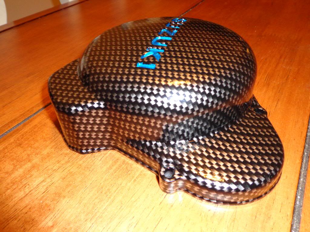

Ive been getting into hydrocoating and ill be building a large dip tank soon and opening a business for this.

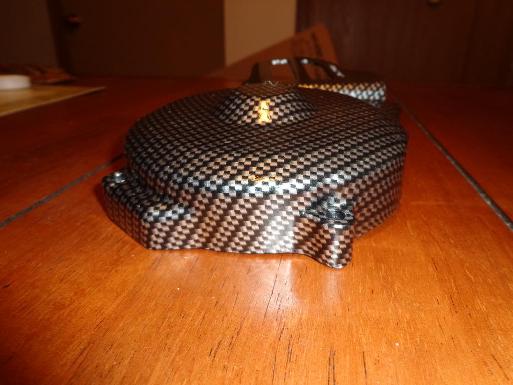

A lot of you guys probably dont know what it is so just check out the pics. Its a very durable finish as strong as any paint and less likely to chip. Im doing it with some friends and we put a lot of time into the prep work to make sure everything gets a nice finish.
Im going to be testing it on some more blaster clutch covers tonight, but because of how the process works and the shape and contours of the blaster clutch cover im not sure if ill be able to do them. There are some limitations wen it comes to the shape of what your dipping but for the most part we can do anything.

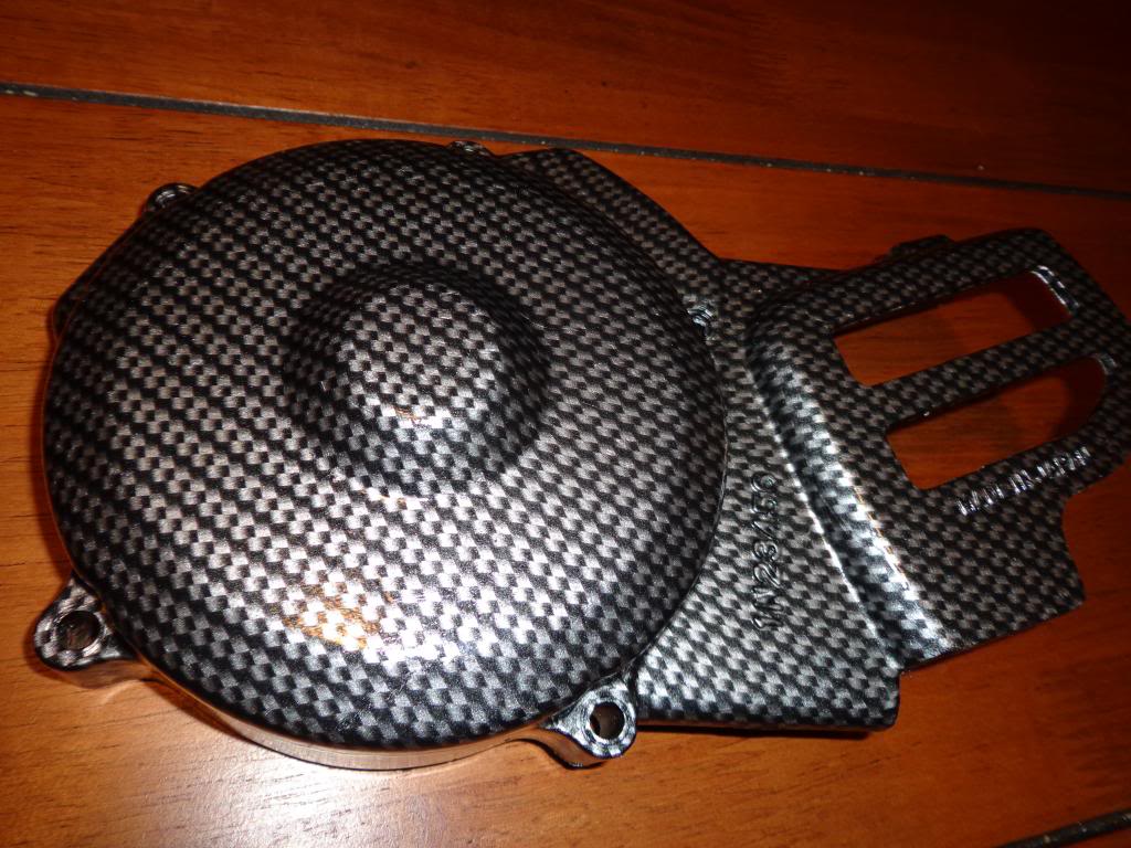

I have several blaster stator covers im going to do and probably try to sell for $40 ($30 for forum supporters) I:I if you consider the average selling price for one of them is $30 on ebay i think the extra $10 is worth it for the carbon coating.
If somebody sent me a stator cover it would probably be like $25. Larger objects would be more and if its something im going to have to put a lot of prep work into ill have to charge a little more.

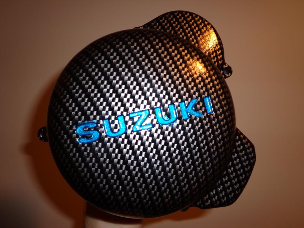

Ill be doing a tank cover and hood probably tomorrow, im hoping i get a finish like the suzuki cover in the pic. The stator cover in the pic was actually a different pattern, looks almost the same but uses a different base color i dont like that one as much.
that zuki cover looks super sweet. will it hold up to the temps?
Its not really any different then the oem paint job so it holds up well. We prep and paint it for the most part just like you would anything else, then the carbon pattern is applied. The pattern is ink not paint and once its applied its fused to the base coat, after the pattern is put on it gets a good thick clear coat to protect it.
Plastics are done a little differently in some cases you can apply the graphic directly to the plastic with only a adhesion promoter, this is the ideal way to do it the finish is basically as strong as the plastic.

Well i spent pretty much all night getting parts ready, tomorrow i should have 5 stator covers, 4 of the little plastic piece on the top of the bumper, and a bunch of ignition back plates done in the carbon and up for sale. If anybody wants some parts done just pm me.
