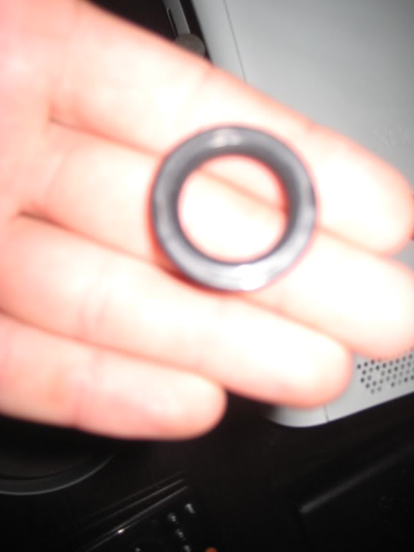

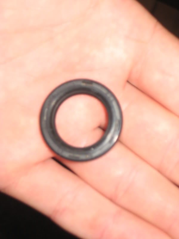

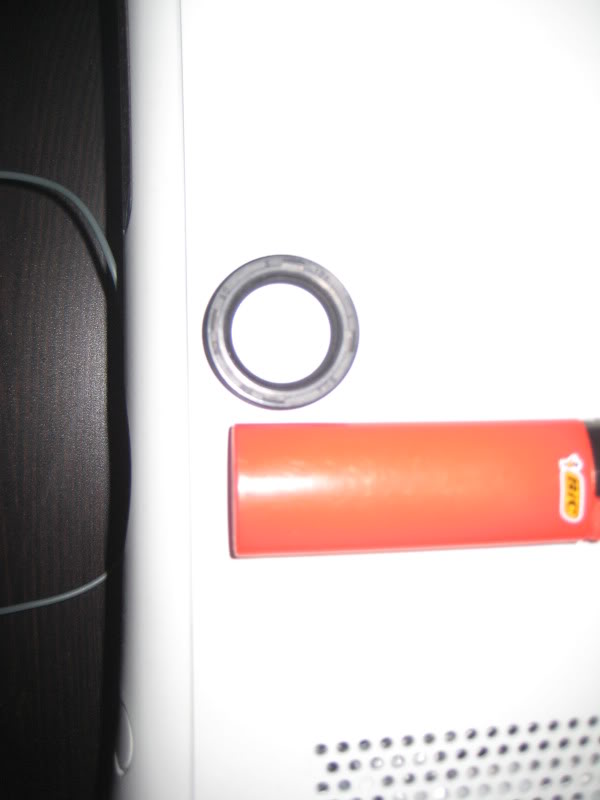

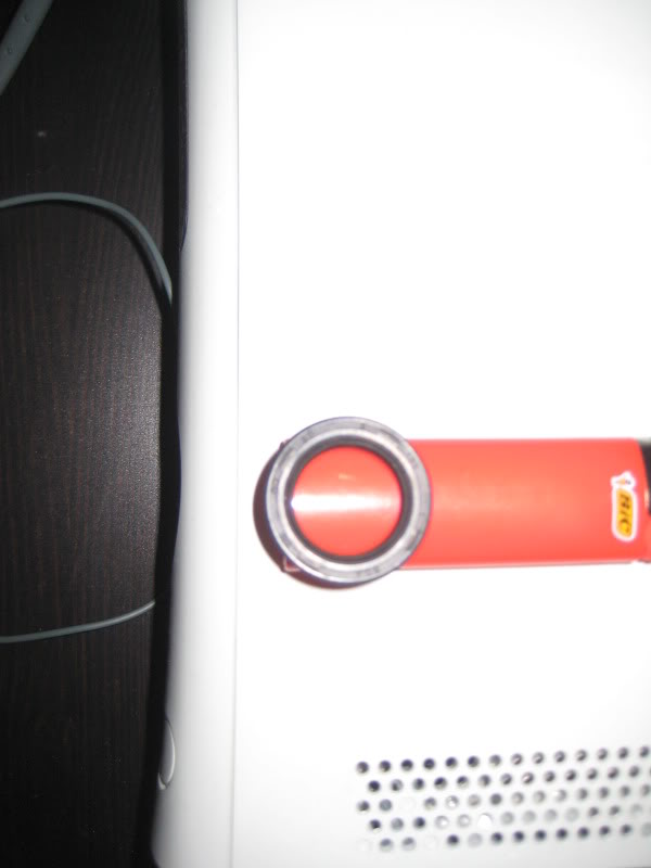

Here ya go took a pic with a lighter to show the size Its the biggest one I had left in the pack and I know for sure the others were for the clutch arm seal, shifter shaft and one more small one. This one i am almost 80% sure is the sprocket seal. Brand spankin new lol.
Edit looking on ebay this seems not to be the right one, hmm
