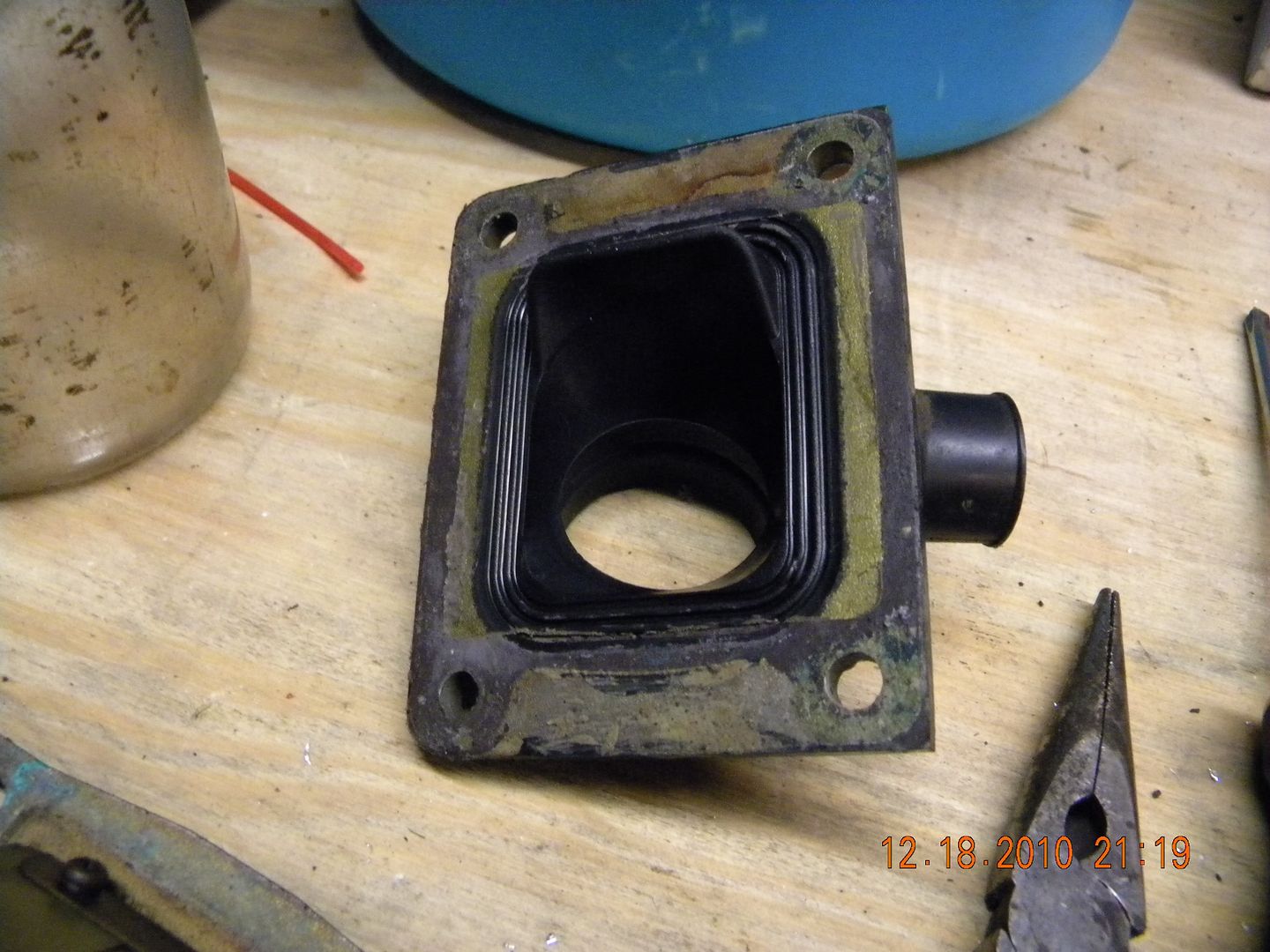

also i took the reed cage off and its got likke dual lookig reeds wanna reaplce them cant make up my mind theres

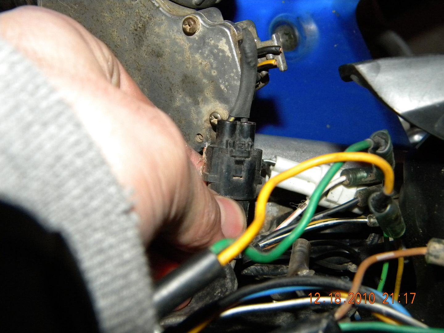

bike is totally stock but there two wires shrink wrap under the head light and two wires i think there tors cut on the carb yellow and black i think

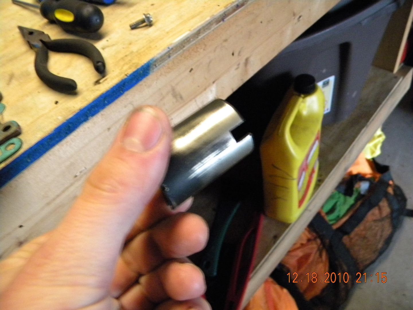

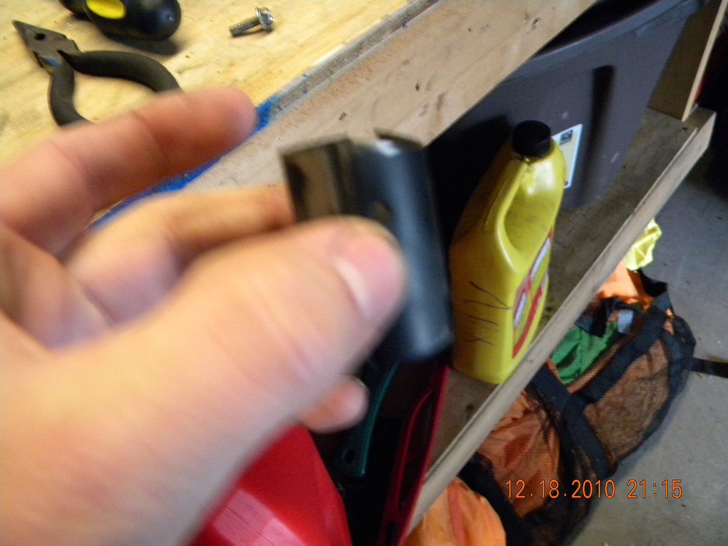

also when i pulled the big need off the top off the carb and the big round metal thing with the needle sticking out of it its black and stained if that normal
110-120 is ok for compression , its not great and that means a new top end should be done soon . That means the cylinder needs to come off , and have it machined for the next size up piston .
I have Boyeson power reeds , and they work great , I also have a set of the vito's dual stage reeds I have never used , so I can't attest to their performance , but I hear they work good.
so are u all stock like me i only have a new stock air filter and i still have the lid on at all times i just didnt know if power reeds fit in stock cage and if u HAD to have mods done or will they wwkr for a stock bike... or just should i get stock fiber reeds

yes that is what the slide looks like after it is used for a long time. they all look like that. def resize your pics. if you use tinypics pick the measage board size
so should i get a new one and the cylnider looking thing thats a slide j/w thanks sry the pics are so big can u tell me what the wires that are cut i think there tors there some cut flush were the thottle button is and fluch cut on the thing above the carb and also there two wires that are just hanging oin the front thanks
the wires are the old tors stuff. sounds like it has been eliminated. no you don't need a new slide that one is probably fine the paint just wears off over time.
ok also whats reeds should i get u think the boyesen super stock or power reeds or vitos duial pedals thanks so much and and advice on a good carb rebuild kit thanks so much
link doesn't work. but you should really look into a clymers manual. they are on ebay all the time. between 20 and 30 bucks. it's worth millions though. I liked the boysen carbon fiber reeds. they will say that they are for the rad valve if they aren't for the stock blasty reed cage. I haven't heard anything bad about any of the carb rebuild kits so you should be fine with whatever you get.

Also, the wires under the hood are from removing the tors box. Are they well insulated? You don't want the black/white one to ground to the frame.
