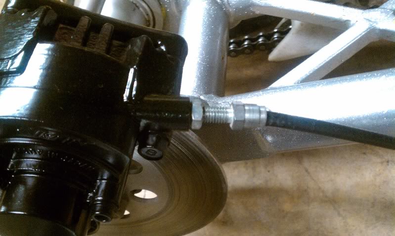

Basically you take off the cable from the lever on the handlebars all the way to the caliper, your going to be using the cable that goes from the lever to the foot peddle, your gonna cut off both barrels, and go to the auto parts store and get a package of assorted barrels, they come in like 5 or six in a pack.

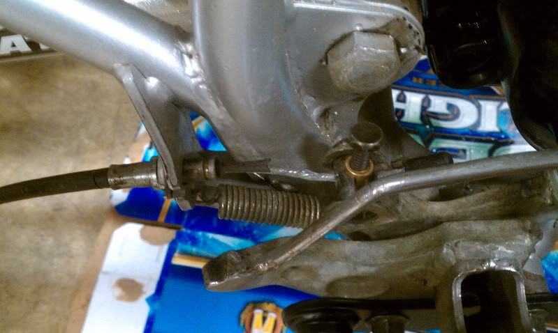

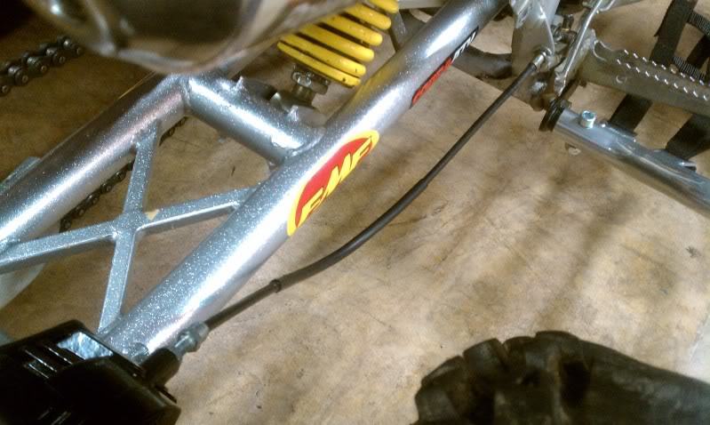

Take off the rear caliper, remove the cable completely since your going to be using the longer cable. Put the caliper back on, and measure from where the cable goes in to where it attaches to the foot peddle, add an inch or so, to give yourself some leeway for cutting. Now take the cable that you just cut the barrels off of, and cut the outer sleeve back enough so that you can slip the adjuster for the caliper on and have enough to go inside the caliper to the lever with the new cable barrel, do the same for the other end.
May take a few times to get the length just right. On the peddle end, you may have to pinch the holes closer together but only slightly.
After you have the cable cut, and the ends on, adjust your slack, and there you have it. New longer cable for less than $5 or $10 depending on the cost of the new barrels. I:I
