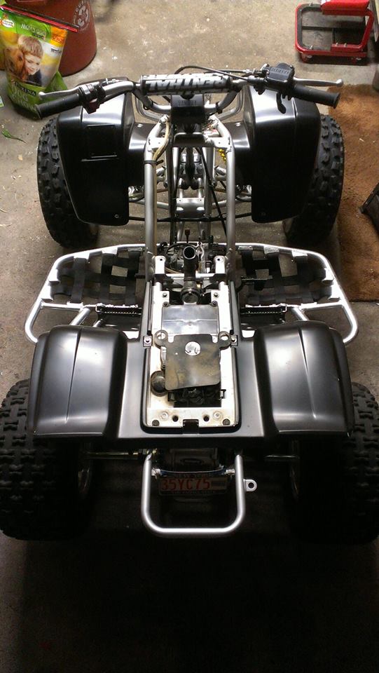

heres a pic of the newly aquired blaster. shes very clean, never really been riding, in my honest opinion its like it just rolled/wheeled out the show room floor. Came with the regi from the dealership when it was bought new in 2002.

could you post a pic of the side of it with the extender on?

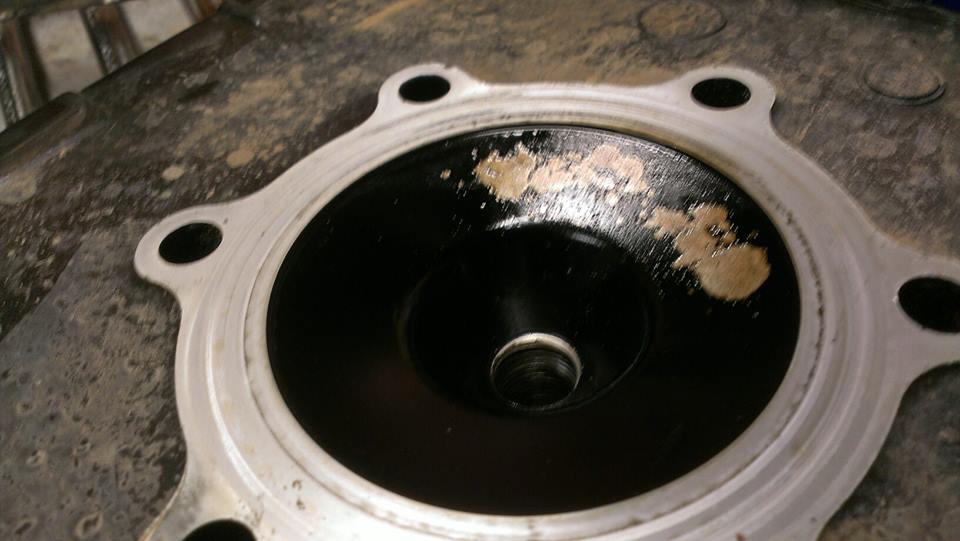

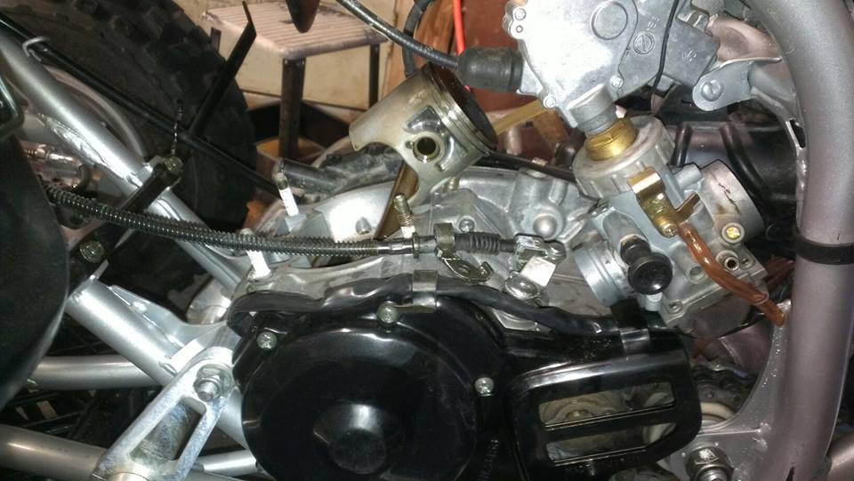

pulled the top end today after work. no manual or anything like that, just pulled the tank, pulled the carb, pipe, head pop right off, and the jug took a lil persuasion with a rubber mallet on one side and then popped right off.
heres some pics.
still have to yank the piston, its fine in my opinion, im thinking all it will need is new rings and hone the jug, but well see when ken says, ill send it to him with the top end so he can make a correct judgement. also the piston gets ported correct ? so hell need it either way. also as the piston isnt off yet, ill make a better judgement once its off, but should i just replace the roller bearing for the hell of it, im gonna say its gonna be mint like the rest of the motor etc etc.
doesnt look like detonation to me, it looks like it just took off the carbon build it up. agian the quad has at this point maybe 20 hours or so on the orginal motor, the previous owner just took it up and down the block. so im guessing me riding it hard started to blow off the carbon build up. i also ran techtron so that may have attributed to blowing the carbon build up off. or may be completely wrong lol.

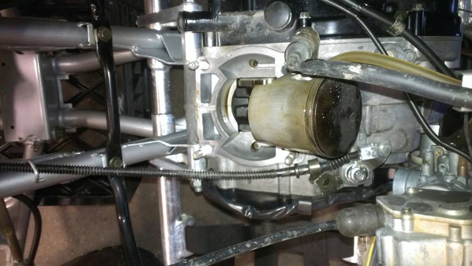

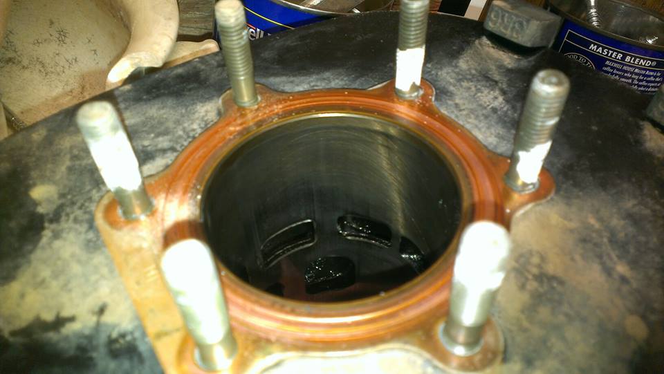

got the piston off the rod.
what a easy machine to work on. only things left are to clean up the case mating surface with a razor blade, and remove the remaining exhaust.
sending the top end and piston out to kor tuesday i hope. agian ill request base and head gasket, new piston circlips, ask for a new roller bearing if he recommends it. the rest is in his hands as far as new rings or just new piston. and whatever carb jets he recommends.

picture of the side of it now please?
havent forgotten about ya. give me a few weeks. its now apart in the garage, with other things behind it etc. when i put it back together and roll it out into the daylight i deffinatly will take a pic for you.
