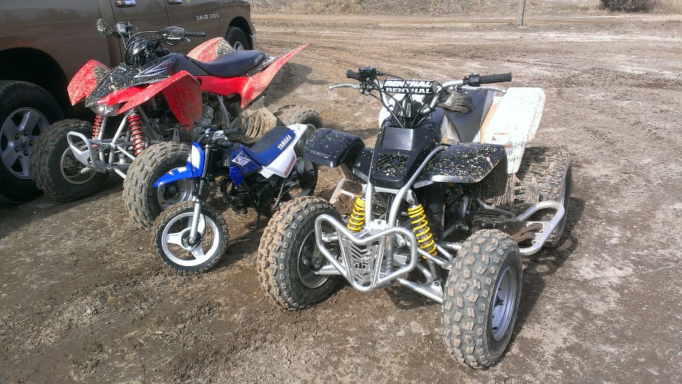

heres the only pic i took, after she got dirty. My brother in laws brand new 400ex, my nephew/godsons yamaha pewee and my blaster.

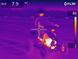

Yup, here is 3-4psi in this picture with my 210 lbs on the machine:

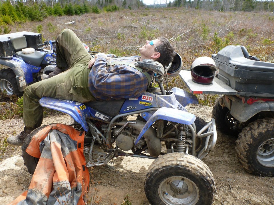

Yup, the old army pants don't quite fit like they used to:

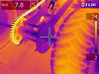

FLIR photgraphy has verified this (properly inflated / over inflated)
But look, don't just blindly take my word for it. Get a low pressure guage and test it out for yourself at 8psi - 6psi - 4psi and 3psi.
See what works best for you.
