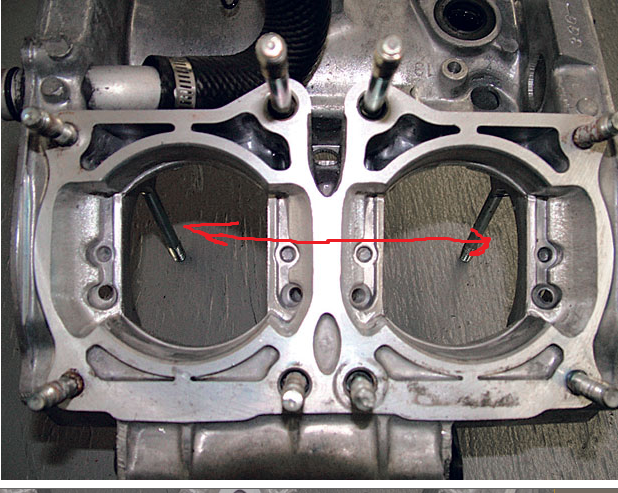

i just got this pic off the net to give you guys a better idea,but this is what i mean by side to side
I am about 60% certain that the certer crank bearing (pressed into the middle of the webs) handles the job of "thrust" control on a banshee. I know the two outside bearings are "pinned" roller bearings and not capable of handling the thrust. Sounds like it may actually be time for a manual and possibly case splitting.

From what I just looked up, a little side to side is normal but must be in spec. Also read that stock non welded cranks tend to separate sometimes. I take it that a Banshee crank is cast in two halves and pressed together.

It's machined and pressed like a blaster crank EXCEPT that the banshee has three main bearings versus the blaster's two.
One main bearing and crank seal set is pressed in between the two rod throws. The other two bearings and seals are set on the crankshaft and then they have a small pin which has to be set into the crankcase to align them properly.
Just like a blasty crank, a little side to side is ok a lot of side to side is too much! :p
You're getting a new crank anyhow, why sweat it. Actually four bearings, two in center w/seal between one on each end. Basically all four would have to be bad to cause excess end play, a seperated crank wouldn't cause excess on it's own. New cranks ONLY come with all brgs. Ticking noise could be brg going.
