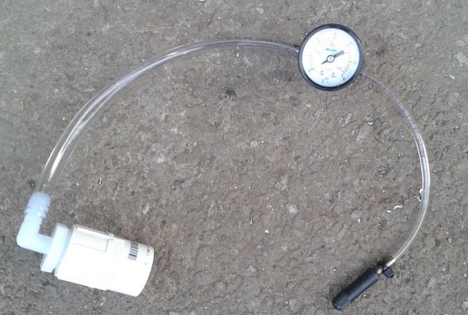

So, before jetting and making sure everything is right, im making myself a leakdown tester tomorrow to make sure i don't fry anything before pulling hard while jetting... i had this question tho... i've seen the leakdown tester thread...
Question is: how do i fit the hose to the PVC part, do you seal it with silicone or epoxy?
Thanks!
Thanks!
hose to pvc fittings requires npt thread to barb fittings, like this 90 degree adapter off the intake fitting, i got at my local hardware store.........
