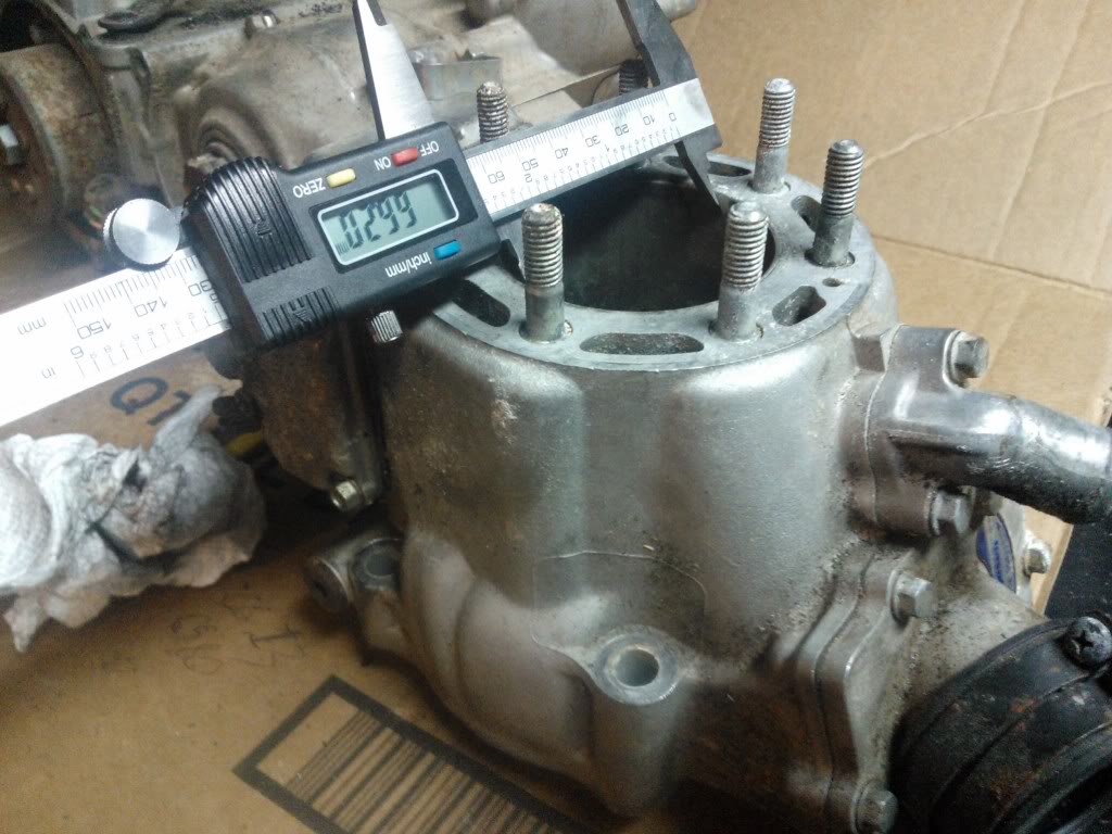

I have a 98 kx250 engine and need a piston. I keep measuring the cylinder and coming up with 66.10 . Looked on ebay and found dozens of new pistons with a standard bore size of 66.4 . My question is, are there a jug size of 66.10 or is there only 66.4 and up. If so my digital caliper could be off. Also if the jug is 66.4 do I look for a piston for 66.4. Do the pistons go by jug size so lets say its say 66.4 and the pistons size really is 65.5 lets say. I'm a noob when its comes to this kind of stuff so any help will help me alot.
You can see here its says 66.2.. but stock is 66.4 wtf :-[
i think you need to measure at the bottom ?
here...........
Cool got a better reading at the bottom. It was 66.4 . And on top of the piston it said std which I guess stands for standard. I guess I can order a piston. I'll call ken tomorrow to see how much he can get them for. This is just a bike I want to get running so I don't need top of the line stuff. I'll save that money for the blaster.lol When is your next big ride. If you have it closer to lost trails I'm down to go.

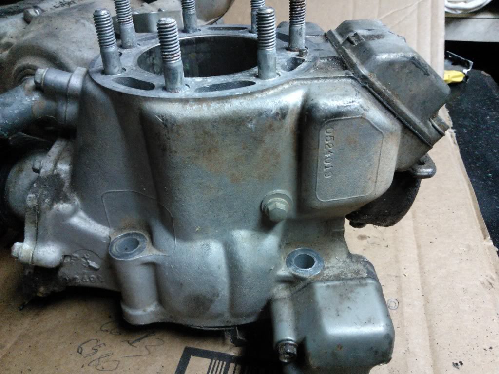

piston size a and b is due to the tooling slightly changing size over the course of production. at some point the very slightly enlarge the piston to make it back in spec. on motorcycles that went through HUGE production runs like the cbrf2 ive seen all the way out to like piston f.
which one you fit depends on you, i know a shop that always used a pistons no matter what. where as 99% of the time i do an overbore and an aftermarket piston making the letters on the stock bore useless. considering there will be engine ware no matter what i would try to measure the bore and fit one that gave me the correct PtW clearance.
