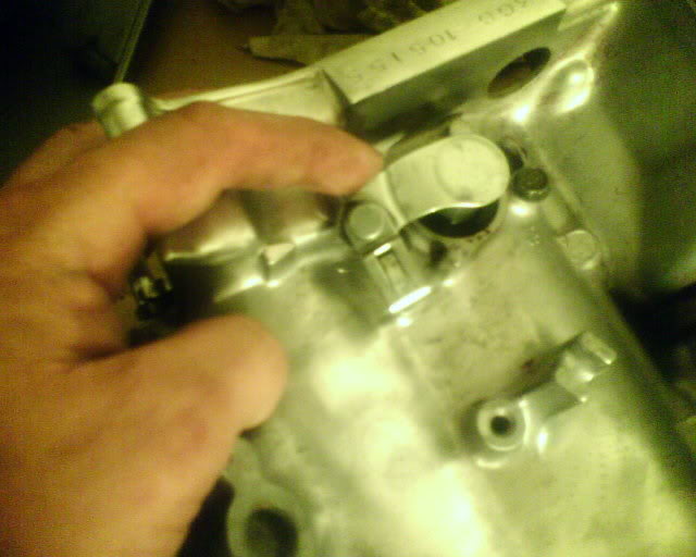

So just rebuilt the bottem end on my banshee and thought everything was normal but whenever I shift it into gear. It will still move freely as if it's in neutral. Note I'm also shifting with the quad offif that makes a difference. shifter shaft is moving the star just fine too. And I know I put the plates in correctly

Idk what it is but now if I put it in first and hold the clutch in, it will lock the tires up.. And will only go into first,neutral, and second no higher

here's the dots that need aligned
full

The ball is in there And I definatly have it lined up. Idk why it will still roll when in first gear or second.

did you look at what he said?? there is an "arrow" on the case and an "arrow" on the clutch actuator that comes out of the case. Make sure those are lined up!
Do you see the arrow? Push the actuator until you cant and if these dont line up you need to adjust it on the clutch side until it does.
