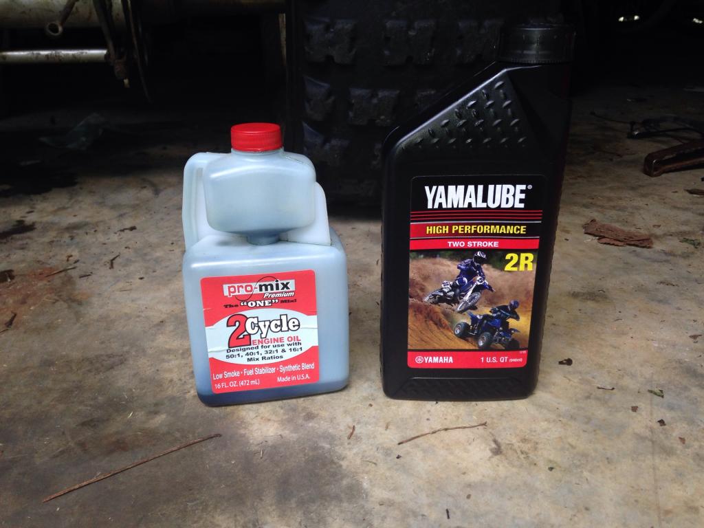

Dealer was great. Got my jets, lug nut I was missing & the correct oil. Hers a side by side of what I put in initially. Also, guy helped me get the high performance oil because I'm pre mixing. Is that other oil a no-no? Thinking about draining the tank and putting only this yamalube in. Think I'll be alright if I don't?

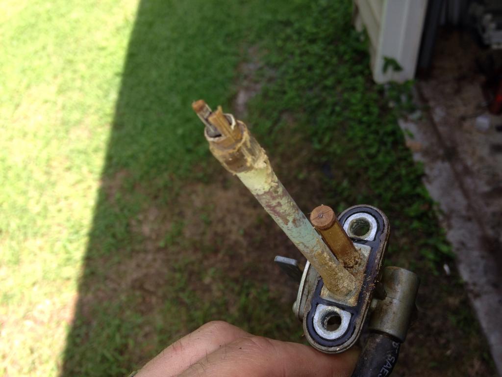

Ahhh crap. Was hoping it wasn't. Copy that! Draining weed whacker garbage ASAP. I really need to get with my neighbor and figure out how to get this thing running right. Figured out my "ON" stem of the gas line is clogged too. It will only run fuel through the "RES". Oh well...

As to the oil, it may have no relation to why it runs poorly, oils are oils.
The problem with the oil is that it is not suitable to lubricate correctly with the excessive variants of temperature produced by air cooled motorcycles.
The film strength to allow the oil to cling to very hot surfaces is just not good enough.
It will work well in temperature controlled 2strokes,(those with forced air cooling) but not well with non forced air systems, which vary excessively in temperature.
I hope my explanation is clearer than mud.

Clean the petcock screen or replace the petcock. A plugged petcock screen is another good way to burn down the motor.
